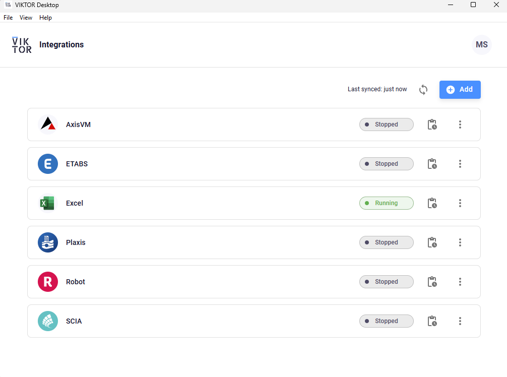

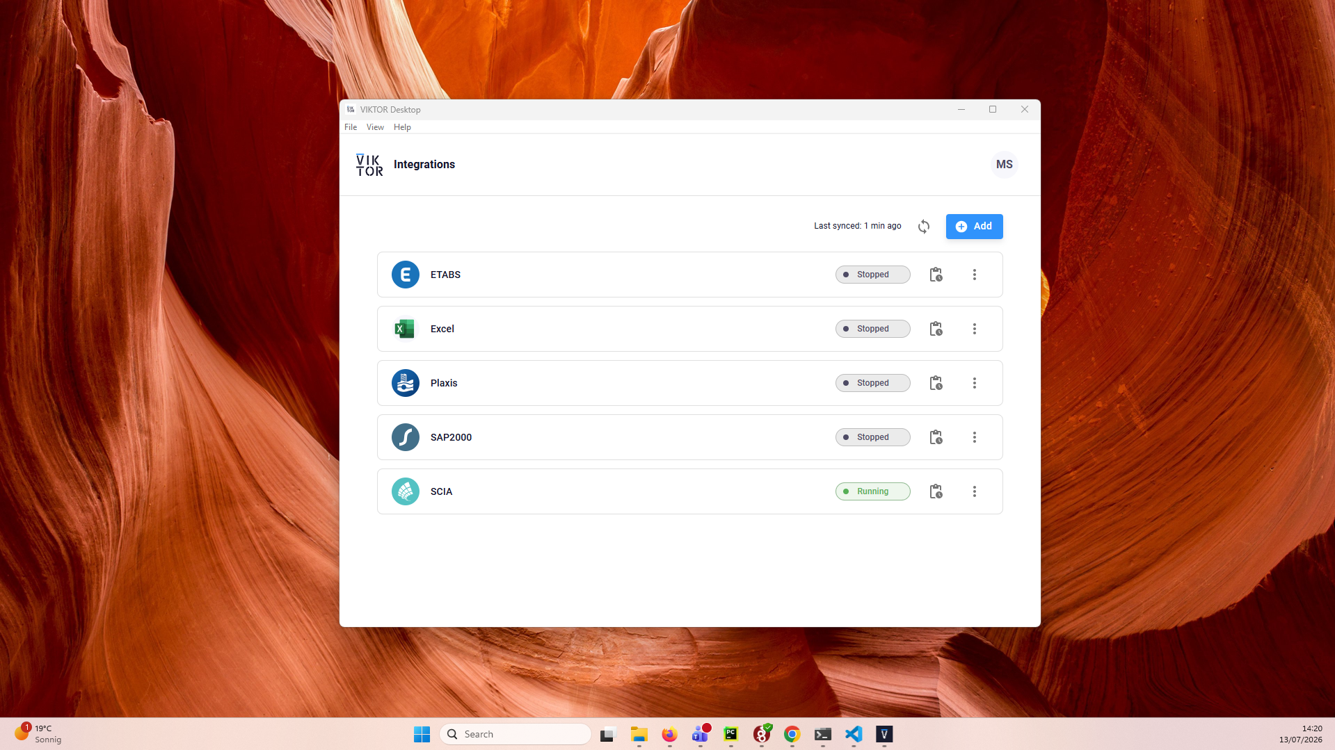

VIKTOR Desktop showing your workers and their status

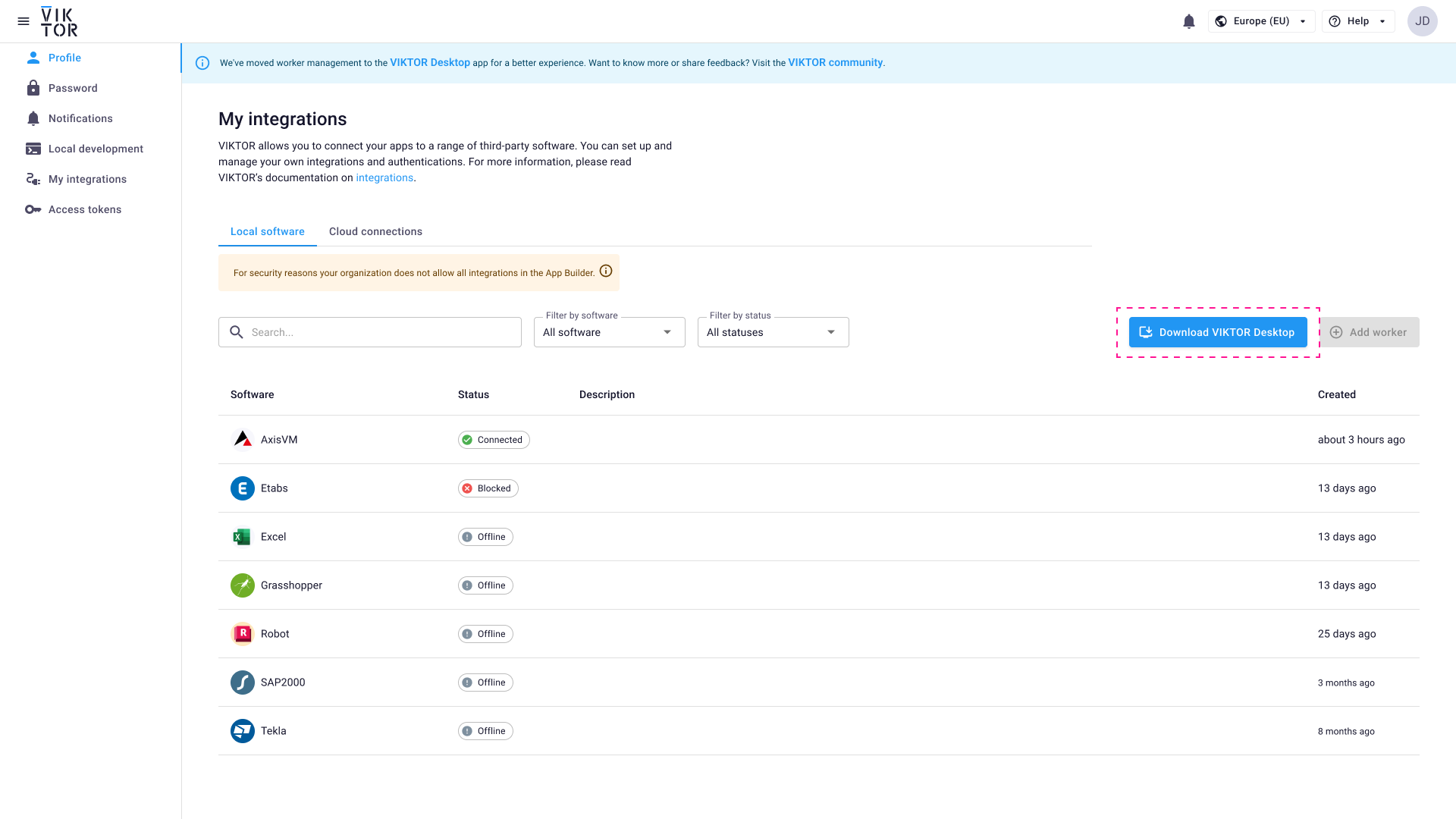

  1. Download the VIKTOR Desktop installer (a signed .msi Microsoft Installer). You can download it directly below, or from:

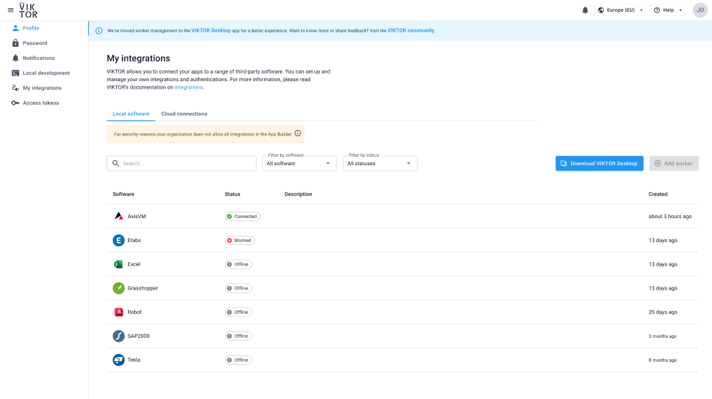

    • the "My integrations" tab in your personal settings, using the "Download VIKTOR Desktop" button on the "Local software" tab, or

The "My integrations" page with the "Download VIKTOR Desktop" button

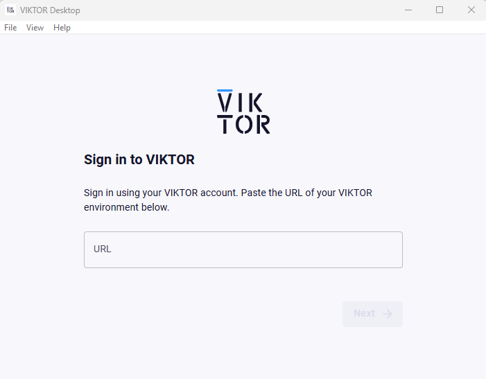

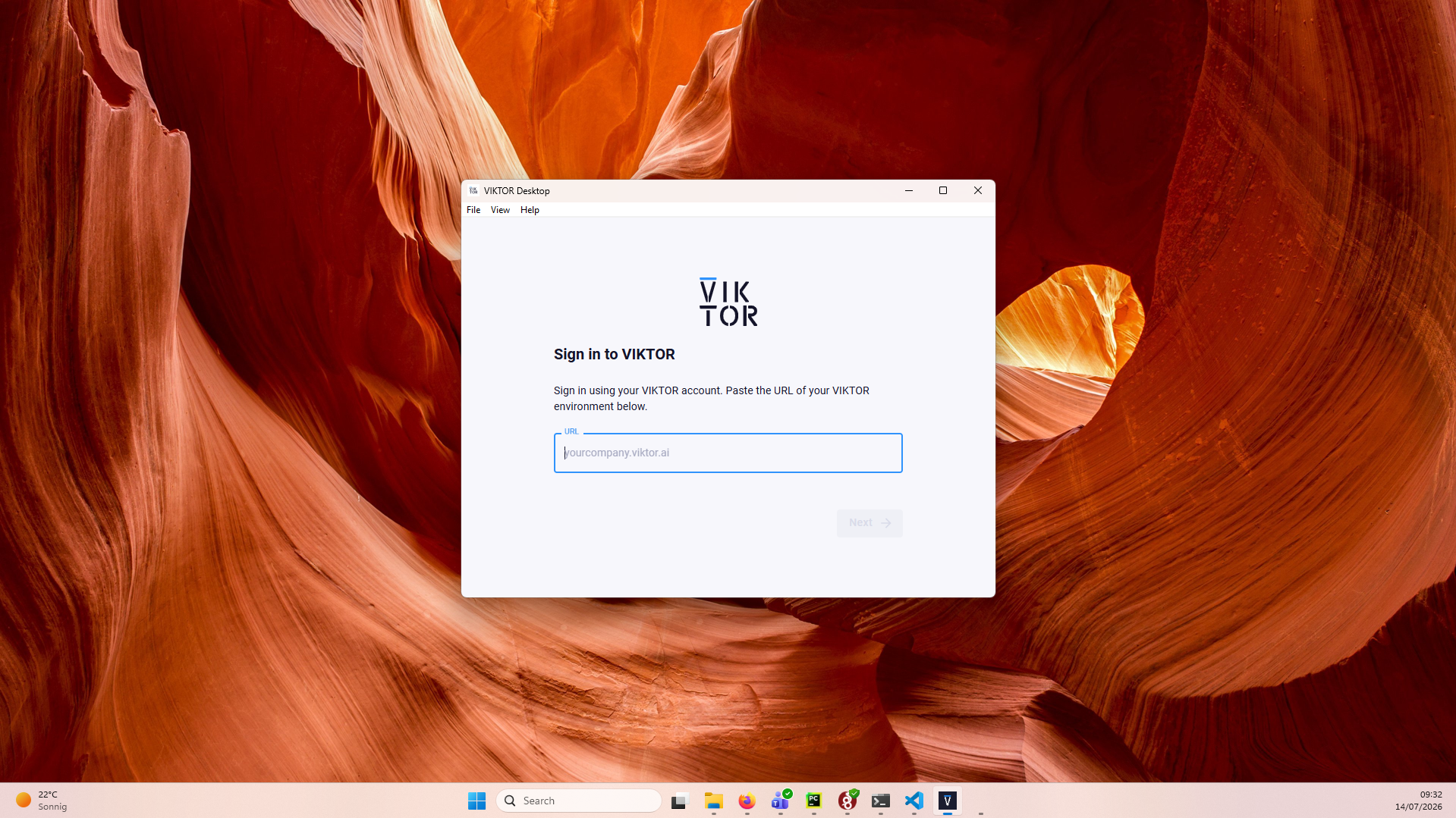

On first launch, VIKTOR Desktop asks you to sign in: paste the URL of your VIKTOR environment, click "Next", and log in with your VIKTOR account in the browser that opens. After logging in, return to the app.
The VIKTOR Desktop sign-in page
You log in once for all your personal workers: no connection keys need to be generated or pasted. To log out, or to switch to a different VIKTOR environment, click your profile in the top-right corner of VIKTOR Desktop and select "Log out".

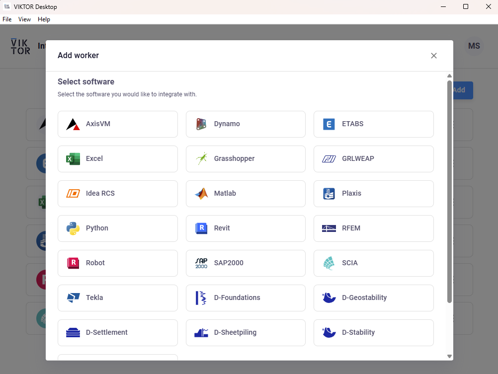

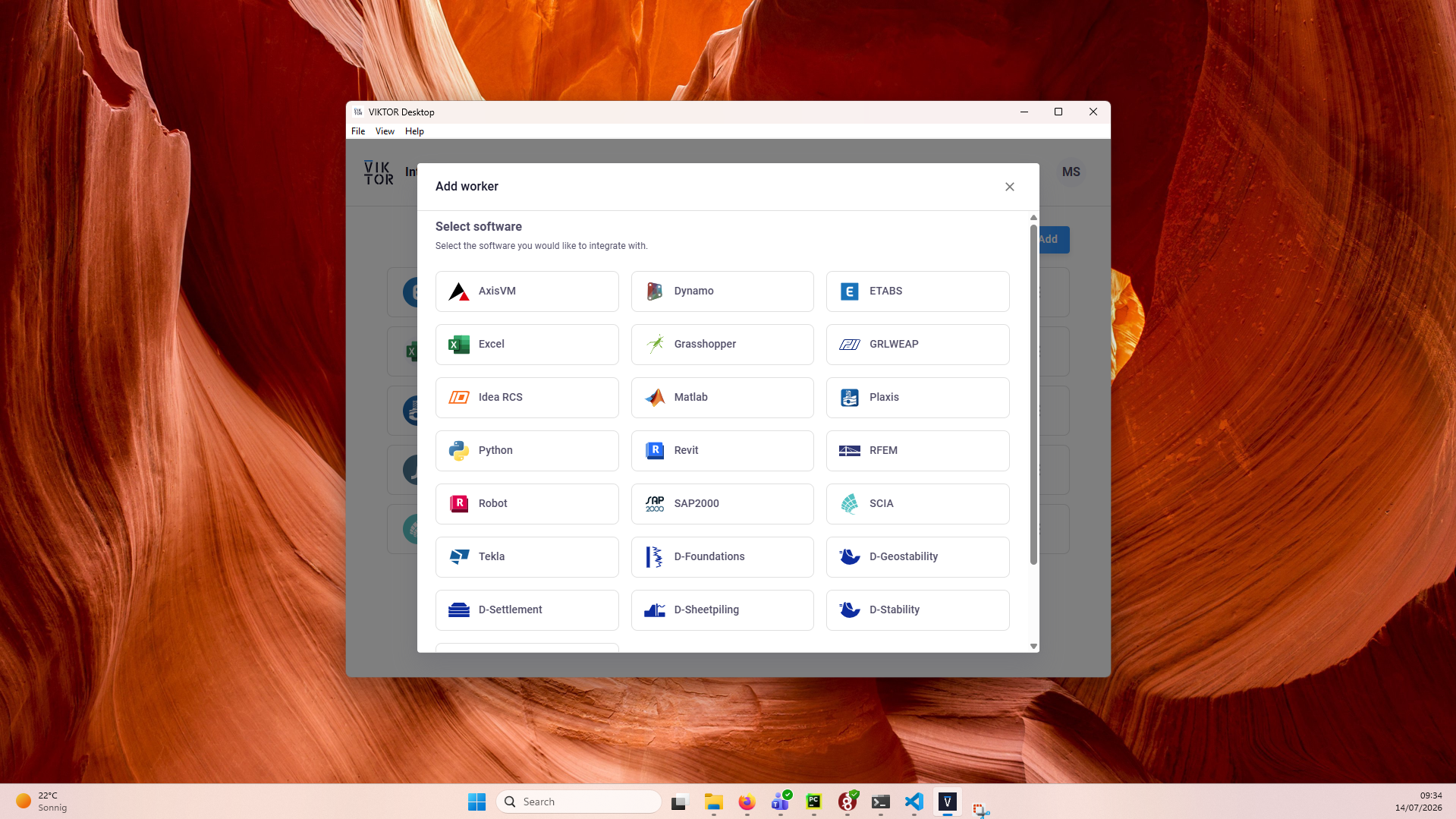

  1. In VIKTOR Desktop, click "Add"
  2. Select the software you want to integrate with
    Selecting the software when adding a worker

Workers are started and stopped inside VIKTOR Desktop and run managed by the app — there is no separate terminal window. The worker list shows for each of your workers whether it is "Running" or "Stopped". When a worker update is available, VIKTOR Desktop prompts you to update; once you confirm, the worker updates automatically — there is no installer to rerun.

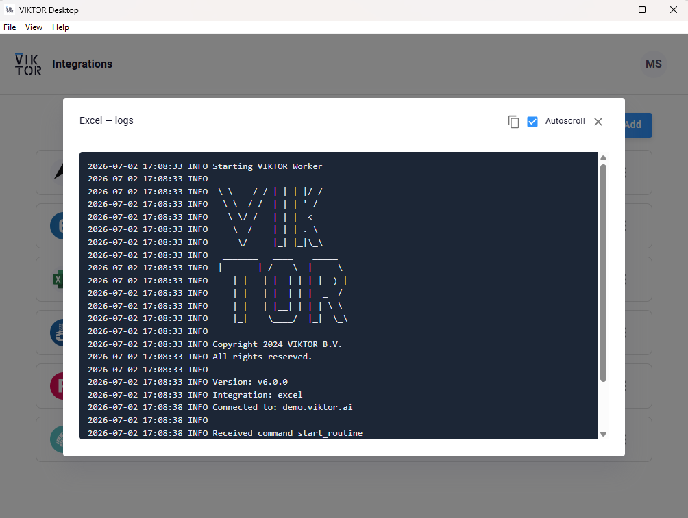

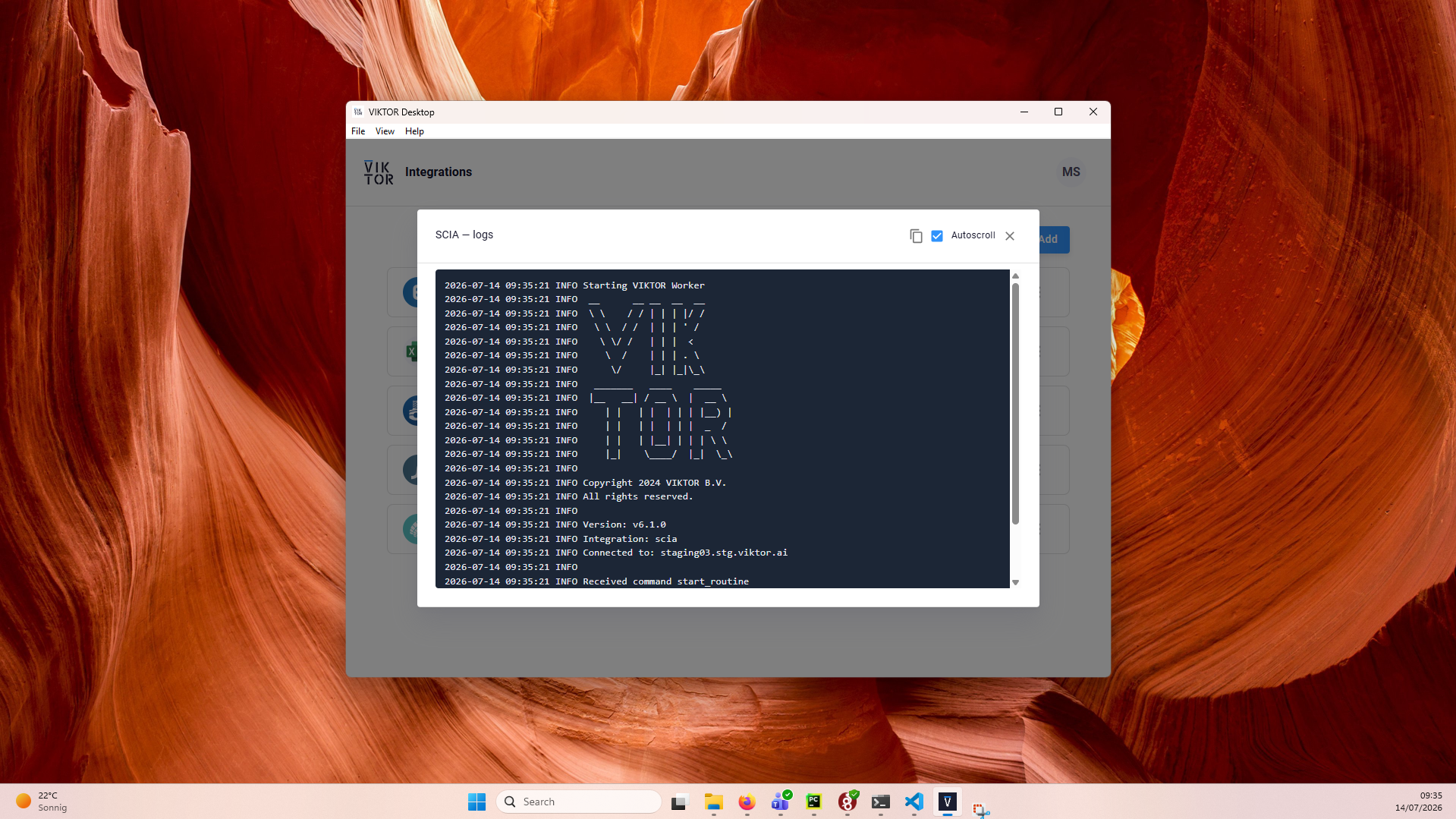

Each worker has its own log inside VIKTOR Desktop. Logs are formatted, showing when tasks are started and completed and any errors the worker encounters.
The log view of a worker in VIKTOR Desktop

New personal workers can only be added through VIKTOR Desktop: with the release of VIKTOR Desktop, the per-worker installer download and the connection-key flow are no longer available on the "My integrations" page for personal workers.
