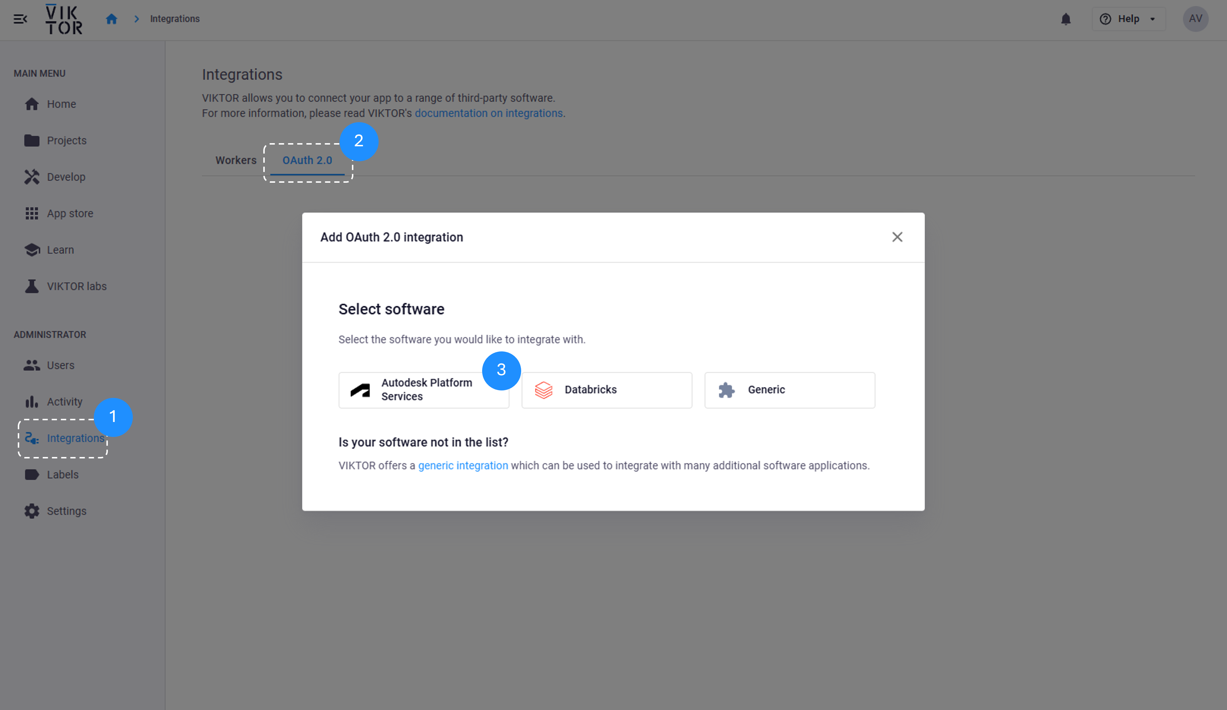

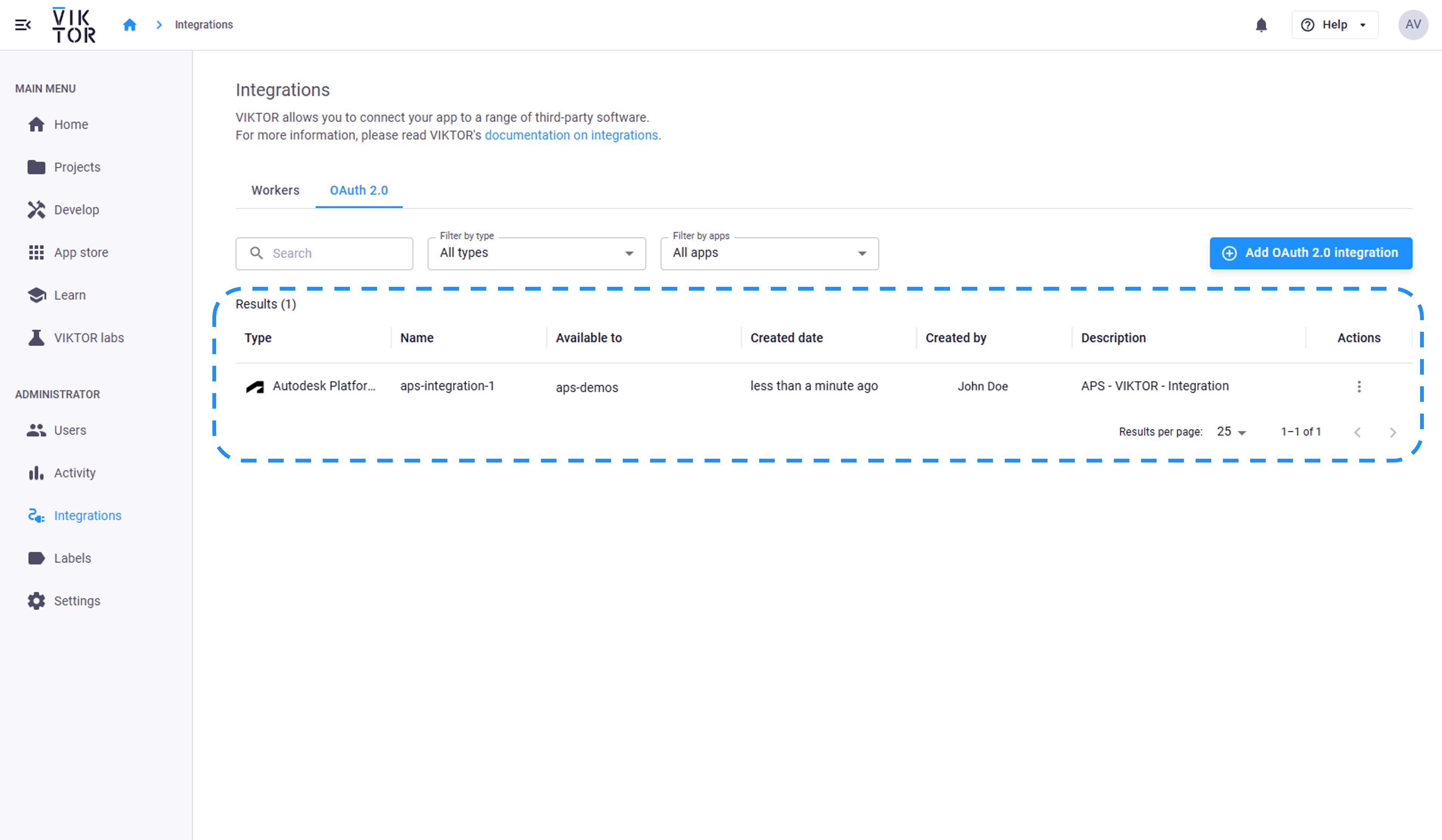

  1. Navigate to the Integrations tab in the Administrator panel.
  2. Select the OAuth 2.0 tab.
  3. Follow the steps in the modal:
    1. Select Autodesk Platform Services.

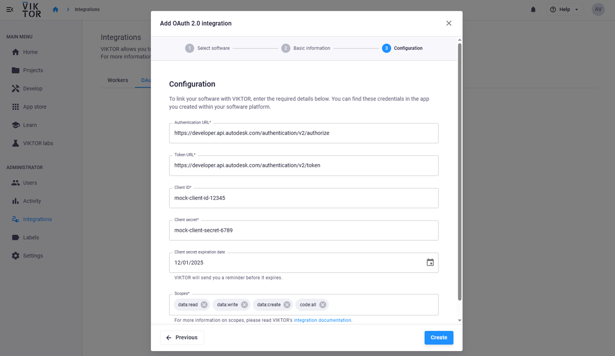

    2. Go to the "Basic Information" tab and fill the required fields, including the integration name, and select the applications that will use the APS integration. You can choose to limit the integration to specific apps or allow all apps on the environment to use it.
    3. Then, in the "Configuration" tab add the Authentication URL and Token URL as follows:
    4. If you already have an active APS application, you can fill in the client ID and secret, as well as the scopes and expiration date, if you do not have one, continue to the next step to create and set up the APS application.

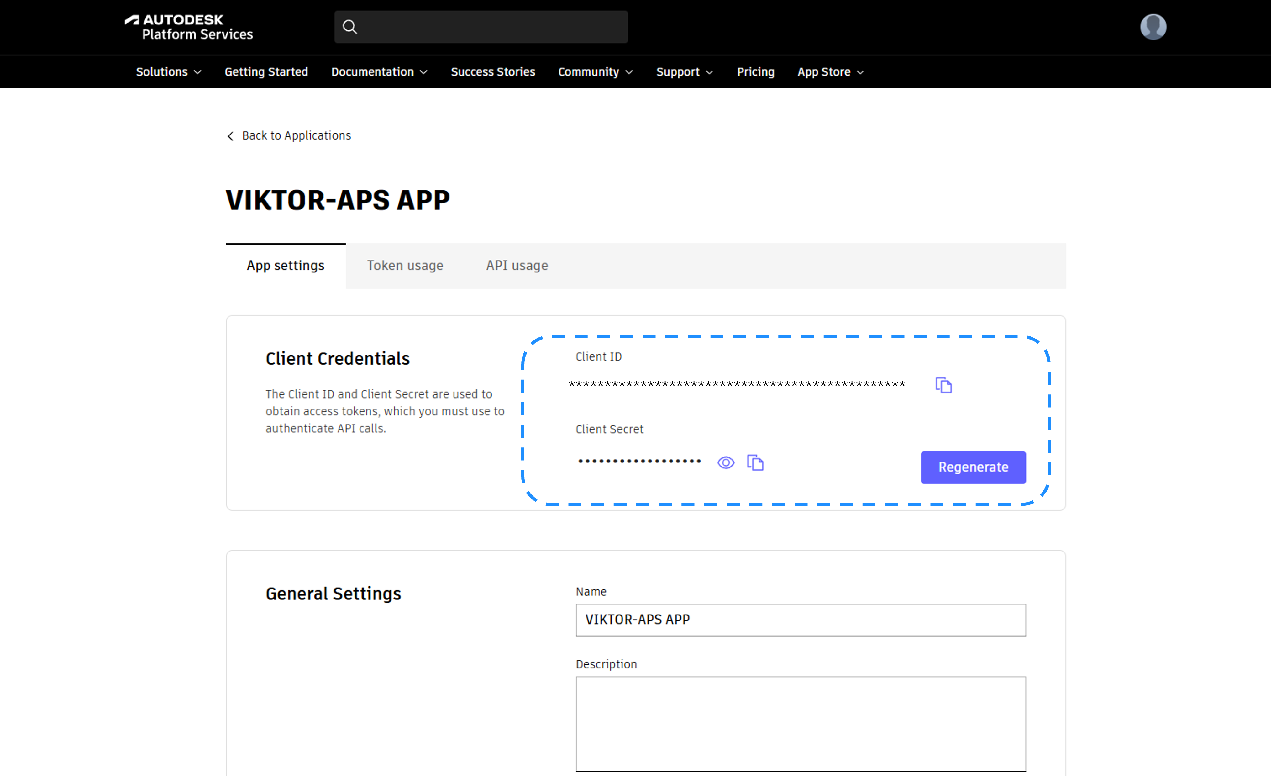

  4. On the APS home page, go to your profile and click Applications.
    1. You can create a new application following this tutorial: Create an app.
    2. Or you can use an existing application.
  5. In the APS application, open App settings and copy Client ID and Client Secret into the VIKTOR modal from step 3.

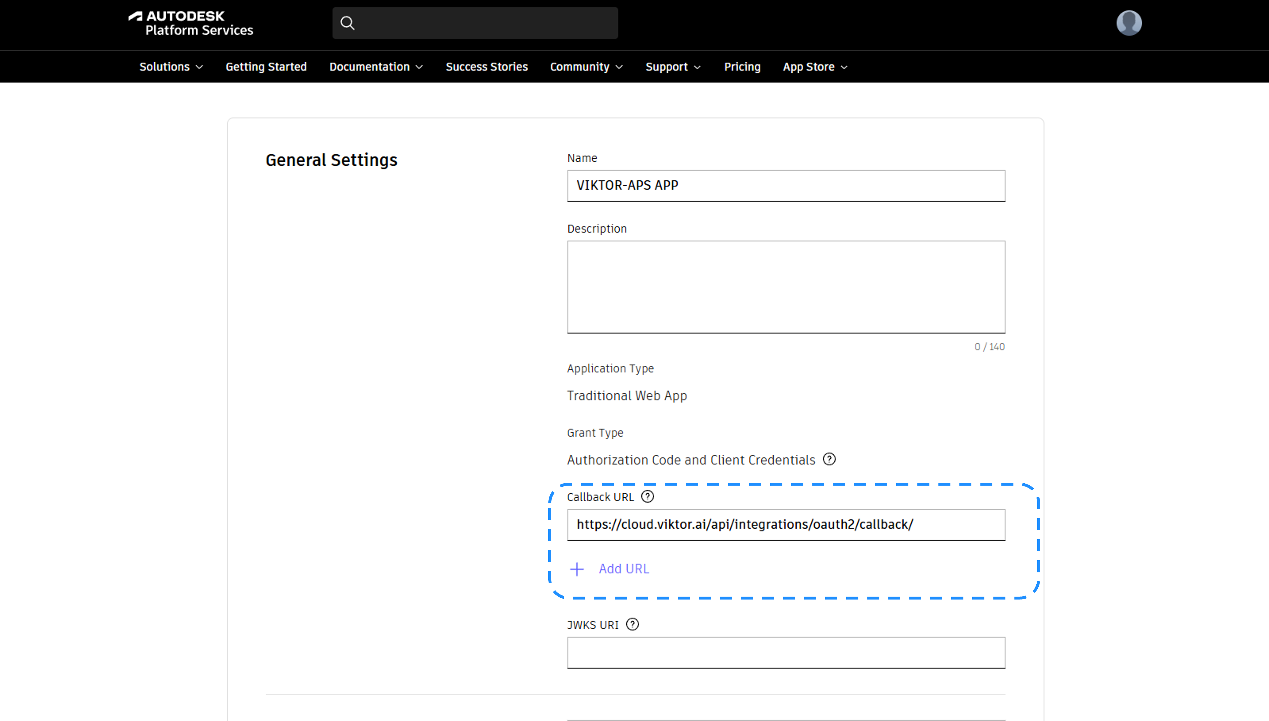

  6. Go to General settings and add the callback URL:
    <your-viktor-environment-url>/api/integrations/oauth2/callback/
    Your environment URL should be https://cloud.viktor.ai/ or similar, depending on your organization.

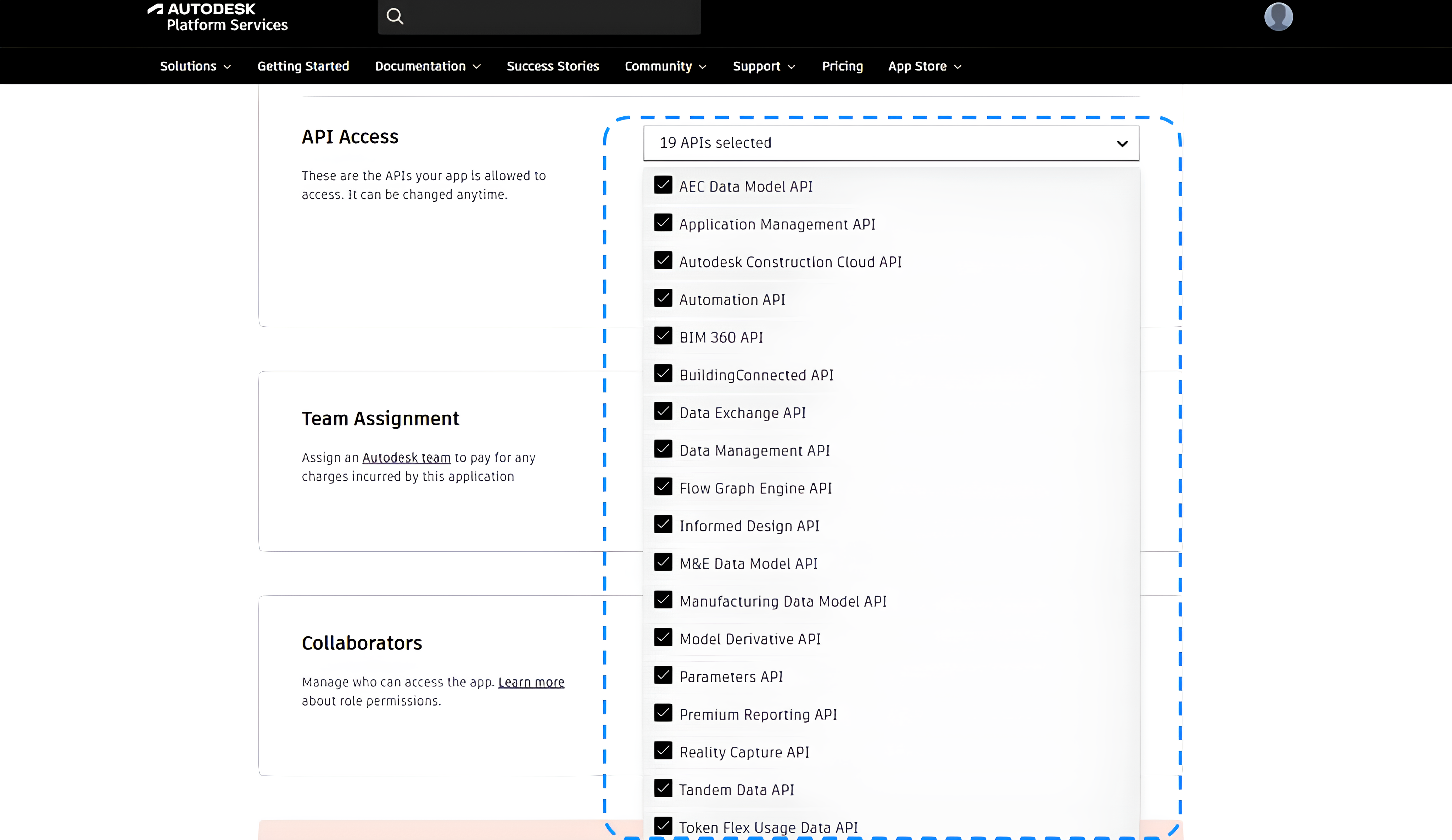

  7. Open App access and select the APIs you want your application to access.
  8. Save the configuration in each section and verify that everything is correctly set up.
Defining Scopes for APS applications
A scope defines what a token can do, it is the permission context for the token. A token that includes data:read can read data in APS, and it works with endpoints that require that scope. A token that lacks the scope cannot access those endpoints. Each endpoint page states the scopes it needs.
The APS documentation lists all scope values in the Scopes section: APS OAuth 2.0 scopes. Common scopes include:
  • data:read
  • data:write
  • data:create
  • code:all
  • data:search
  • viewables:read

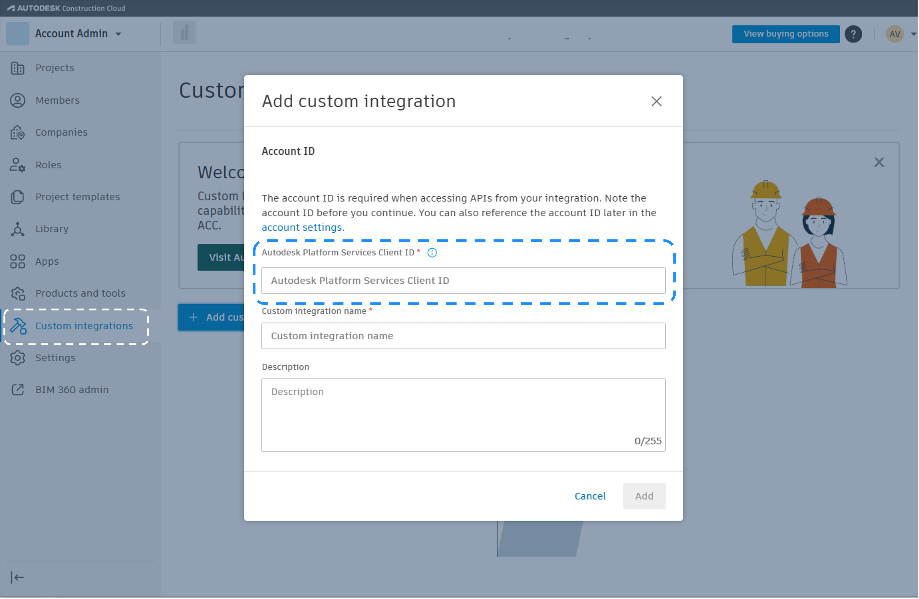

Your VIKTOR-APS integration can connect to Autodesk Construction Cloud using Custom integrations. A custom integration connects your Autodesk Construction Cloud account to your APS application.
The user must be an Account Admin to add the app integration. Follow these steps to connect your APS application to your ACC projects:
  1. Log in to your ACC account.
  2. Open Custom integrations and click Add custom integration.
  3. Enter the APS Client ID from the previous section.
  4. Enter a name and a description for the custom integration.
  5. Complete the integration by clicking Add app.
