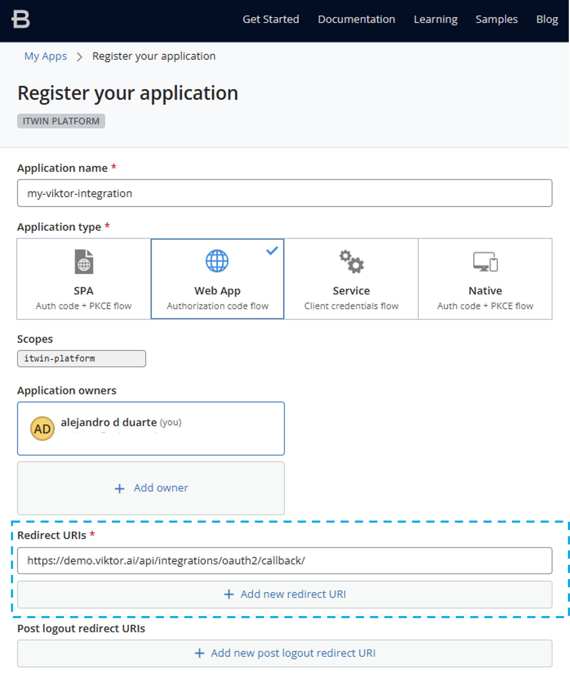

Open Bentley My Apps and register a new application. This application will serve as the bridge between VIKTOR and your Bentley iTwin account, allowing secure data exchange through OAuth 2.0.
When creating your application in the Bentley portal, configure it with the following settings:
  • Application type: Web App - This type provides the client secret needed for secure server-to-server communication
  • Scopes: itwin-platform - This grants access to the iTwin Platform APIs, allowing you to retrieve projects and iModels
  • Redirect URI: <your-viktor-environment-url>/api/integrations/oauth2/callback/ - This is where Bentley will redirect users after successful authentication
The redirect URI must match your VIKTOR environment URL exactly. For example, if your VIKTOR environment is hosted at demo.viktor.ai, your redirect URI should be:
https://demo.viktor.ai/api/integrations/oauth2/callback/
The screenshot below shows the expected Bentley application setup using demo.viktor.ai as an example. Remember to use your own company's VIKTOR environment URL (e.g., yourcompany.viktor.ai).
Bentley application registration

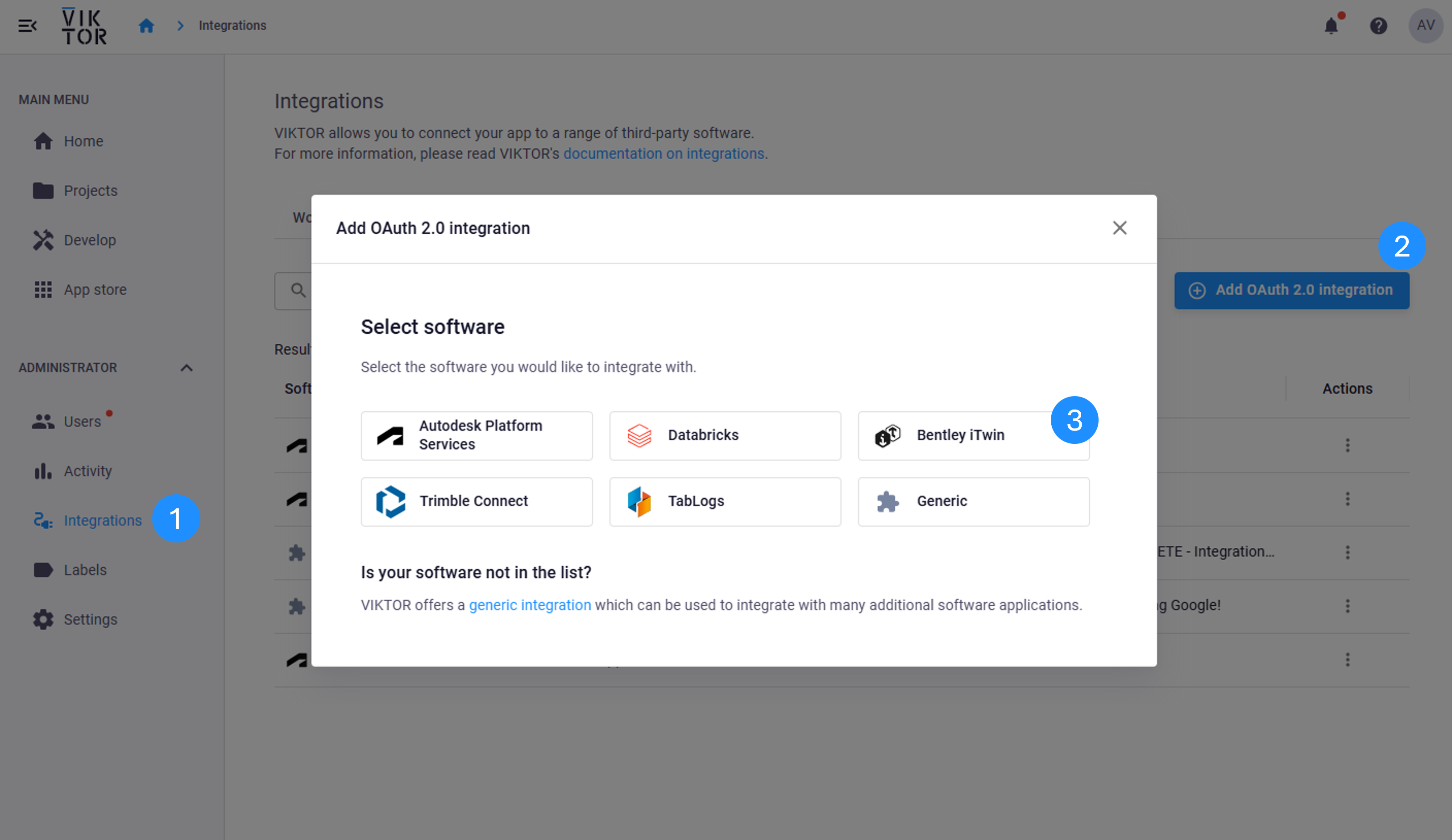

After receiving the Client ID and Client Secret, a VIKTOR admin can generate an OAuth 2.0 integration.
Start in the Administrator panel and create a new OAuth 2.0 integration with iTwin as the selected software.
Open the OAuth 2.0 modal

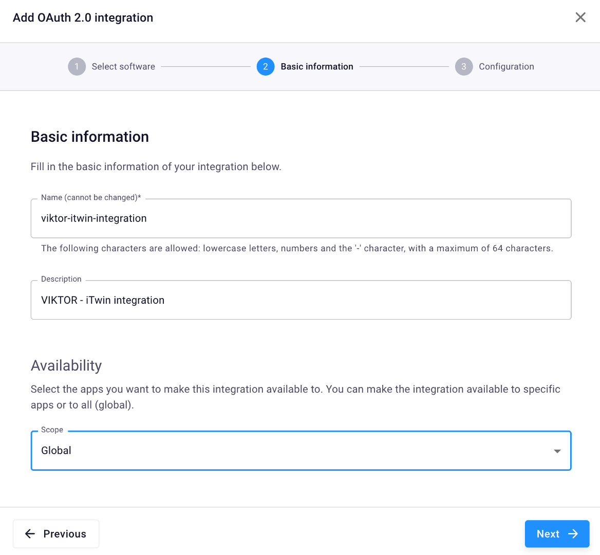

In the Basic Information step, choose a descriptive integration name that clearly identifies this connection. For example, you could use viktor-itwin-integration, bentley-itwin-oauth, or any custom name that makes sense for your organization. This name will be referenced in your application code, so make it memorable and meaningful.
Throughout this guide, we use viktor-itwin-integration as the example integration name. When you see this name in code samples or configuration steps, replace it with your own chosen name.
Add a clear description that explains the purpose of this integration (e.g., "OAuth 2.0 integration for accessing Bentley iTwin projects and iModels"), and assign the integration to the VIKTOR applications that should have access to it.
Basic integration information

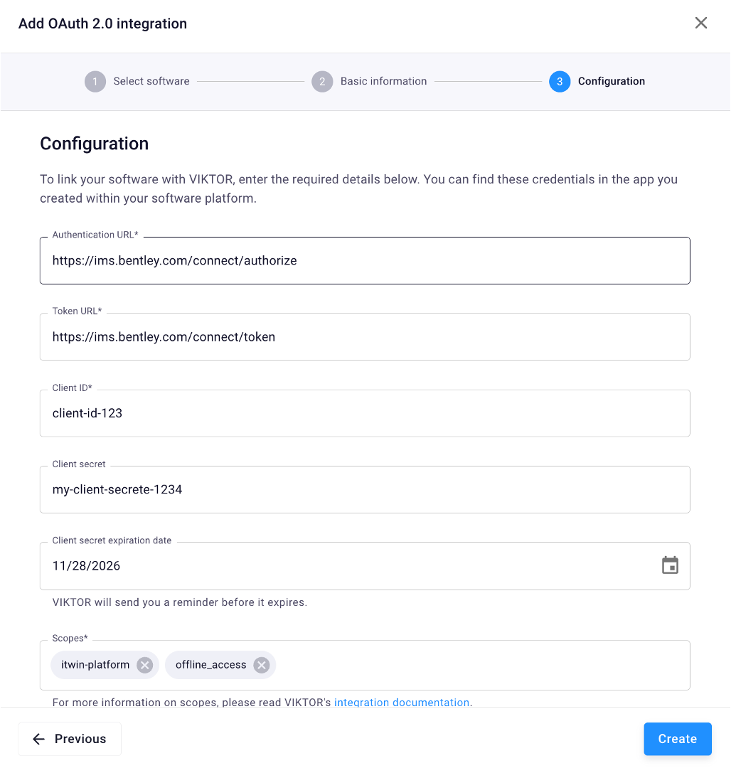

Then, in the Configuration step, use the Bentley OAuth values shown below:
  • Authentication URL: https://ims.bentley.com/connect/authorize
  • Token URL: https://ims.bentley.com/connect/token
  • Client ID: <your Bentley client id>
  • Client Secret: <your Bentley client secret>
  • Scopes: itwin-platform offline_access
offline_access is optional. If you do not need refresh-token support, you can use only itwin-platform.
Bentley OAuth configuration in VIKTOR
info
The iTwin Platform uses the universal itwin-platform scope instead of individual API scopes. Access to iTwin data is controlled by the user's assigned roles and permissions, not by granular OAuth scope selection. For more information, see the iTwin authorization documentation.

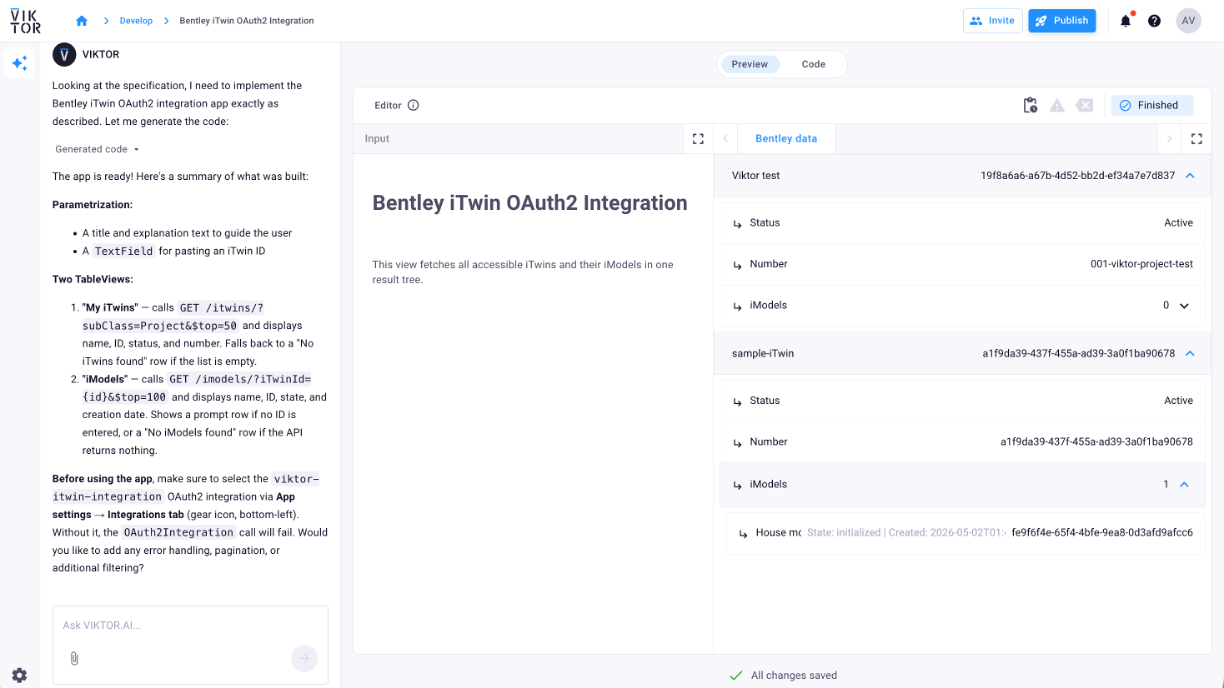

The App Builder provides a no-code approach to create applications with Bentley iTwin integration. You can describe the app in natural language and let the App Builder generate the first version for you.
Use the following prompt:
Create a VIKTOR app that uses the OAuth2 integration viktor-itwin-integration to call https://api.bentley.com/itwins/?subClass=Project&$top=50 and https://api.bentley.com/imodels/?iTwinId=<itwin_id>&$top=100, then show all accessible iTwins in a DataView result tree with each iTwin’s status, number, and iModels; for each iModel, show its name, id, state, and created date, and handle empty results with “No iTwins found” or “No iModels found.”
A generated App Builder result can look like this:
Bentley App Builder result

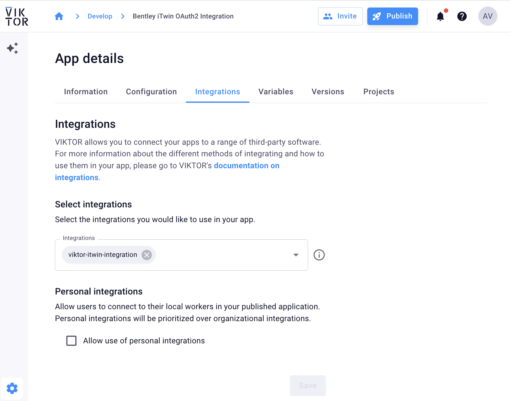

After submitting the prompt, the App Builder will ask you to connect the integration in the app settings:
  1. Click the App details button
  2. Select the integration name viktor-itwin-integration
  3. Save the current selection
Assign the integration in App details
