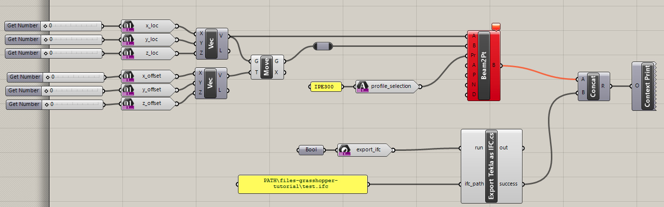

Method 2: use Grasshopper
A powerful connection can also be made with the Grasshopper-Tekla link. Tekla structures are easily created with Grasshopper and the GH-components available. When creating a VIKTOR - Tekla app, Grasshopper can also be used. The main issue is that we want a .ifc from the Tekla model; and Grasshopper nodes don't allow for saving / export Tekla files. This can be solved like this:
- Follow this guide to set up your VIKTOR app that communicates with GH.
- Have your worker look for an
output.ifcin your worker-directory - Use these Grasshopper nodes to create a Tekla model
- Add the following C# component to your Grasshopper file (feel free to replace some defaults, documentation here):
if (run){
Model model = new Model();
success = Operation.CreateIFC4ExportFromAll(
ifc_path,
Operation.IFCExportViewTypeEnum.REFERENCE_VIEW,
new List<string> { @"..\\default\\General\\Shared\\IFC\\AdditionalPSets\\CIP Construction data.xml" },
Operation.ExportBasePoint.GLOBAL,
"__Name__",
"ByObjectClass",
new Operation.IFCExportFlags { IsLocationFromOrganizer = true, IsPoursEnabled = true},
string.Empty);
success = true;
- you can then add the success output to a context print (this way the worker will know the script is finished).
Below you can find an example of how this may look:
