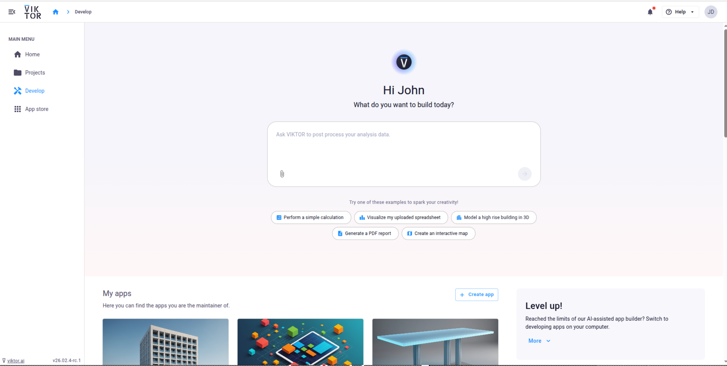

You can start a new app directly from the Home page in the VIKTOR environment.
  1. Describe the app you want to build in the prompt field at the top of the Home page. Make clear that you want to create a new app, for example "Create an app that calculates the bending moment of a beam". Specify the desired inputs, visualization, and logic. You can also click one of the example prompts below the field to fill it in.
The VIKTOR Home page with the "Talk to VIKTOR AI" prompt field and example prompts
  1. The agent shows existing apps that match your request and offers Start building. Click Start building to open the App Builder with your prompt carried over. If an existing app already does what you need, you can open that app instead.
You can also start a new app from the Develop page. In that case you enter your prompt in the App Builder itself.

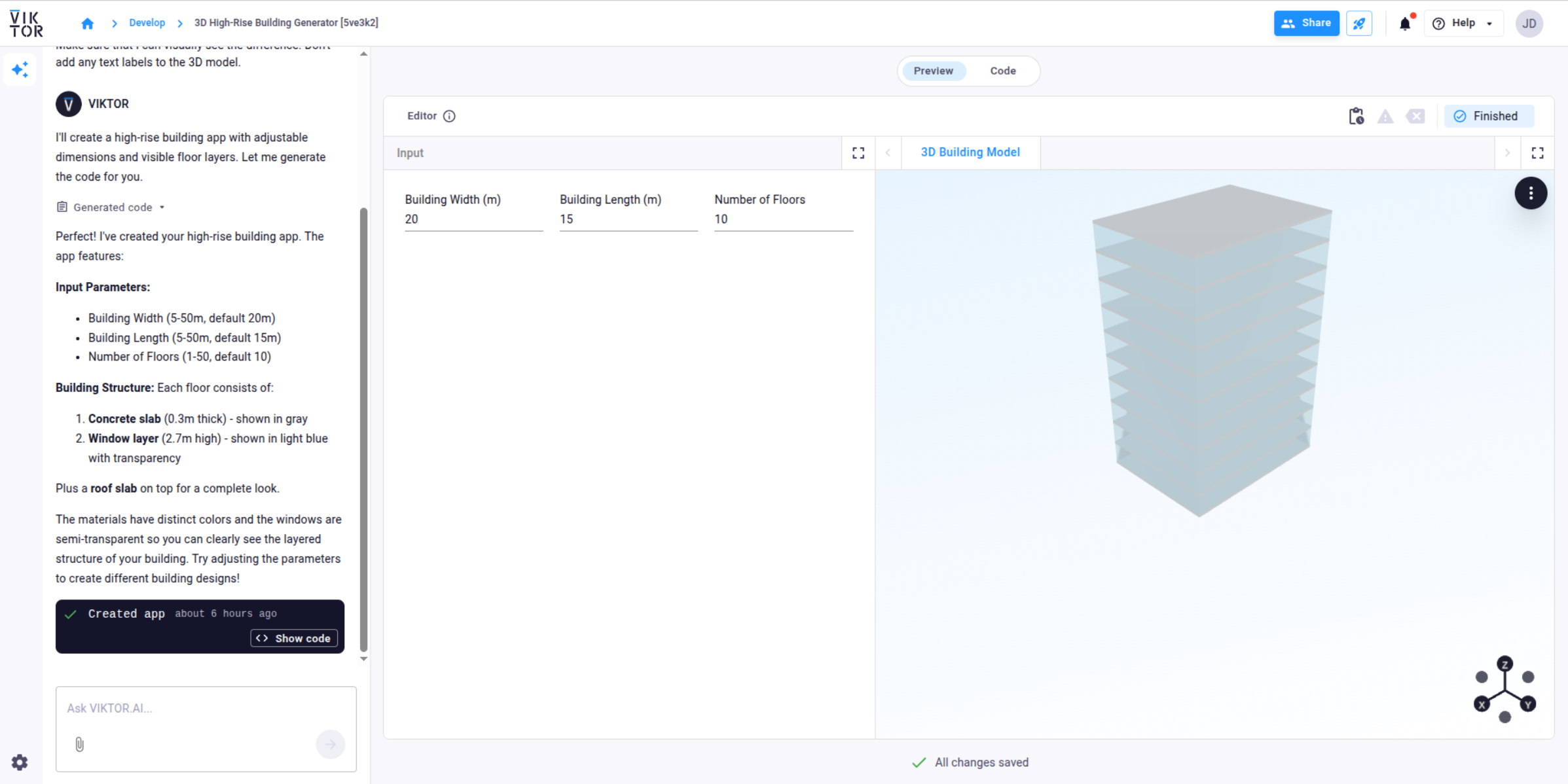

  1. When you send your prompt, the agent will begin generating your app. Once it's done generating the app code, it will provide an explanation of the actions performed on the left side of the screen. On the right, you will see a preview of your app. You can interact with the app in Preview mode to test its functionality. To view the underlying Python code, simply switch to Code mode.
The App Builder with the agent's explanation on the left and a live app preview on the right
The interface​
The App Builder brings together everything you need to build an app in one screen:

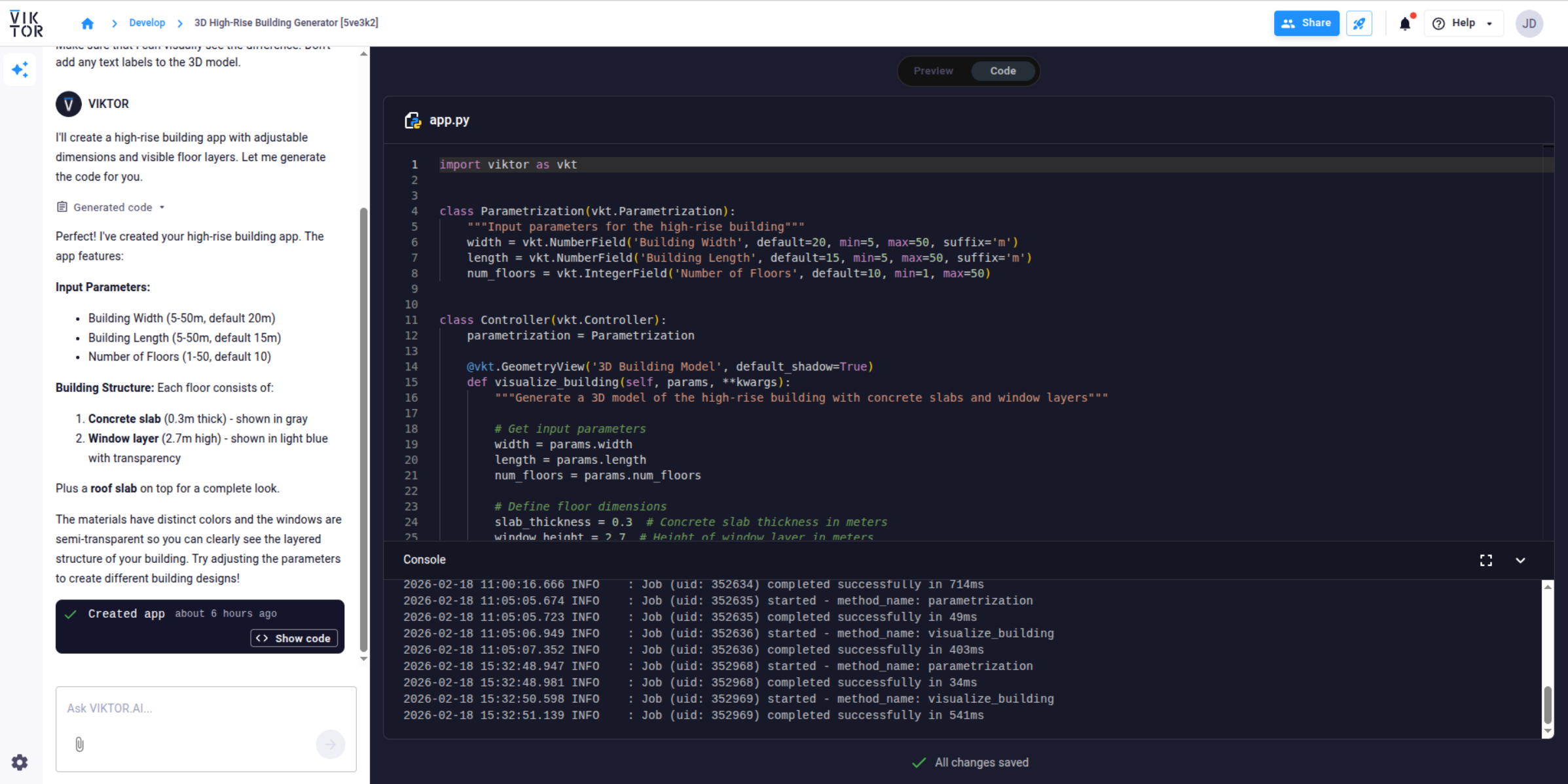

  • Chat panel (left): where you prompt the agent and read its explanation of the actions it performed.
  • Preview (Preview mode): an interactive, live preview of your app. Interact with it to test its functionality; it reloads automatically after each change.
  • Code editor (Code mode): view and edit the underlying Python code. You can switch between Preview and Code mode at any time.
  • File tree (Code mode): shows all files and folders in your app. See Working with multiple files for details.
  • Console (Code mode): real-time logs from the Python process, described below.

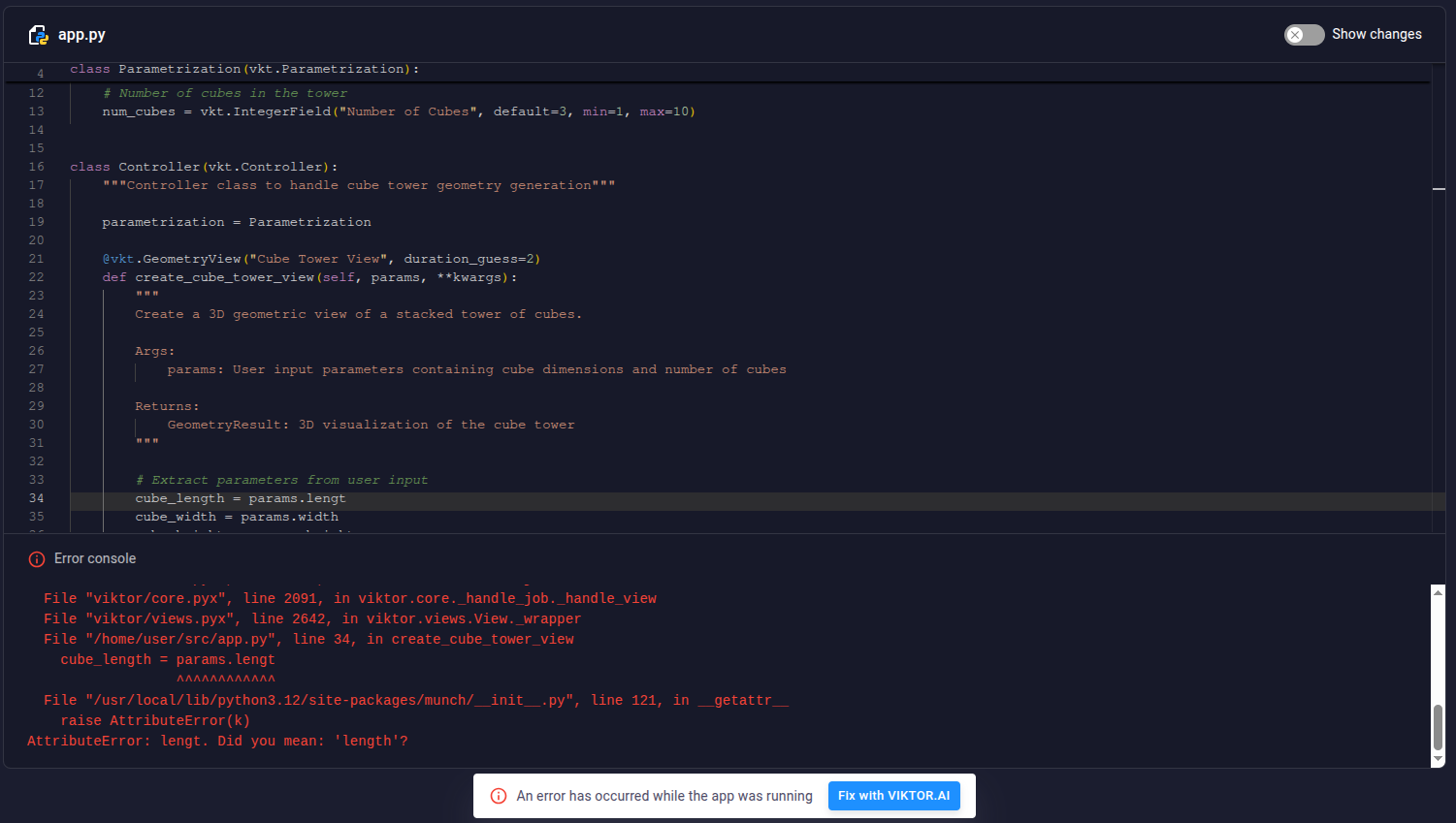

Console​
The console is part of Code mode, alongside the code editor and file tree. It displays real-time logs from the Python process at the bottom of the screen and shows:
  • Output from print() statements in your code
  • Python logs and errors
  • Runtime information from your app
The console is particularly useful for debugging and understanding what's happening during app execution. Simply add print() statements to your code to inspect variable values and track execution flow. See Troubleshooting and debugging for how to use it when something goes wrong.

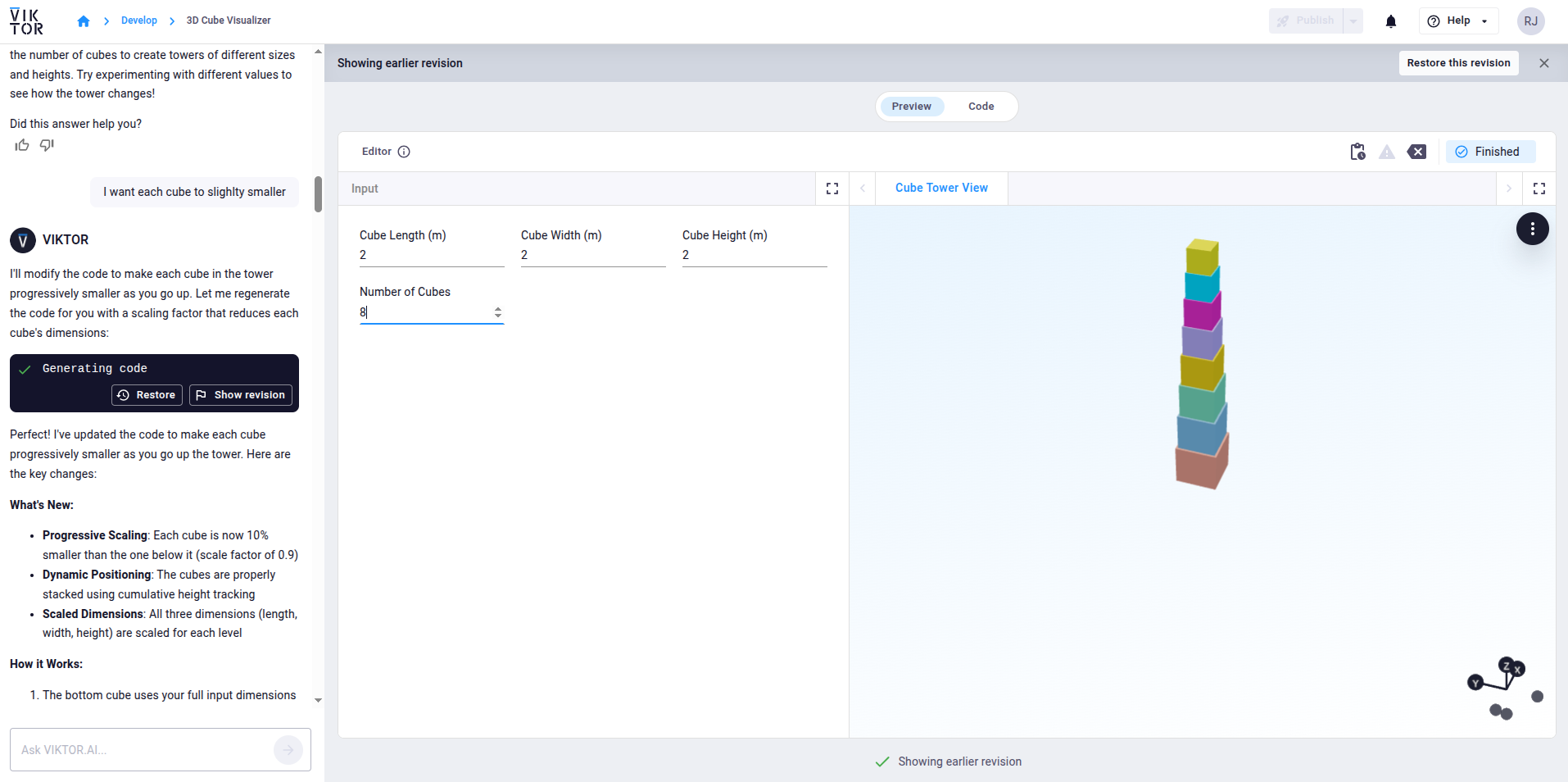

To inspect what changes have been made to your app, click the Show changes button. This will open a comparison of the current and previous revisions. If you are not happy with how the agent has changed your app, you can revert these changes by clicking the Undo button.
The "Show changes" view comparing the current and previous app revisions
Each change made to your app, whether by you or the agent, is automatically saved as a revision. This allows you to restore earlier versions of your app. To find a revision, scroll up in your chat history. You can restore that revision directly by clicking the Restore button. You may first want to see what the revision looked like by clicking the Show revision button, which will load the revision for your inspection before restoring.
App revisions in the chat history, each with "Show revision" and "Restore" buttons

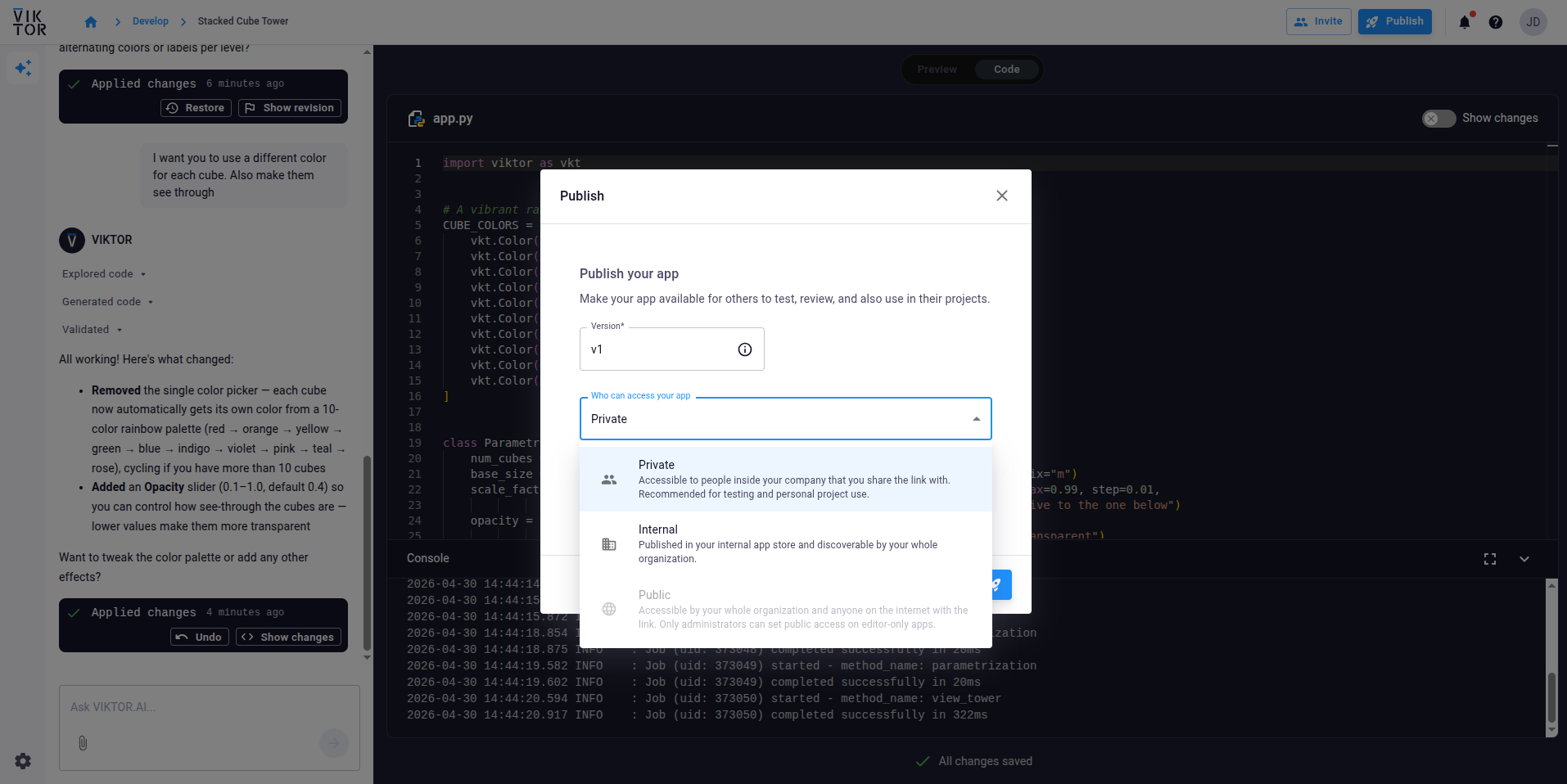

Publishing​
Once you are satisfied with your app and wish to make it available to others, click the Publish button (rocket icon) in the top-right corner. You can choose between three visibility options:
The Publish dialog with Private, Internal, and Public visibility options
  • Private: The app is only accessible to people inside your company that you share the link with. Use this option to invite colleagues to test your app and provide feedback before a wider release.
  • Internal: The app is published to your internal Library and is discoverable by your whole organization.
  • Public: The app is accessible by your whole organization and anyone on the internet with the link. Only administrators can set public access.
The dialog also asks where the version should go: the Testing line, the Production line, or both. Publishing to Testing only lets you try the version out in a testing workspace without changing what people in your projects run. See testing and production versions.
After the publishing process is completed, you can add the app to a project to start using it. You can point either line at a different version later, from the versions tab described in Version history.

Understanding error messages​
When an error occurs, the App Builder displays an error message. Switch to Code mode to see the error with a Python traceback in the console.
An error message in the App Builder with a Python traceback shown in the console
This traceback is crucial for identifying the problem:
  • Location: Look for file names (e.g. app.py) and line numbers. This tells you exactly where the error occurred in your code.
  • Error type: The error type (e.g. NameError, AttributeError, TypeError, ValueError) indicates the kind of problem.
    • NameError: You are using a variable or function that hasn't been defined.
    • AttributeError: You are accessing an attribute or method that the object doesn't have, for example a misspelled method name.
    • TypeError: Occurs when an operation is performed on an object of an inappropriate type (e.g. trying to add a string and a number).
    • ValueError: Indicates that an operation received an argument that has the right type but an inappropriate value.
  • Description: Read the accompanying description carefully. It often provides specific details about why the error occurred.
More information on Python Tracebacks can be found in this Real Python article.
You can ask the agent to fix the error for you by clicking the Fix with VIKTOR.AI button. The agent can also help explain why the error occurred.
