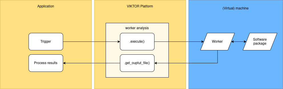

Workers
A lot of engineering software runs locally on your machine. While you could integrate with this software during development (the code runs on the same computer), this will break if your app is used by others in production. In production your app runs on a server and this server does not have access to your machine. Workers solve this issue.
A worker is a small application (executable) that is installed on the computer with access to the local software. It creates a secure connection with the VIKTOR platform, enabling the web applications to integrate with the local software and execute tasks.
A worker is always assigned to one or multiple apps and when executed will run in the background and wait for a 'task'. This task consists of the input(s) required for the software. When the worker receives the task, it will call the software and perform an analysis with the provided input(s). Meanwhile, the application from which the task is sent waits until the worker finishes the calculation and sends back the results. The following schematic shows this concept:
VIKTOR worker flow

Implementation example
Each worker integration makes use of viktor.ExternalProgram. The ExternalProgram.execute method is the trigger to send a task to the worker on the external machine.
The following piece of code shows an example implementation of an integration with SCIA Engineer:
input_esa = ...
input_xml = ...
input_xml_def = ...
scia_analysis = vkt.scia.SciaAnalysis(input_xml, input_xml_def, input_esa)
scia_analysis.execute(timeout=300) # triggers the worker, wait until complete
results = scia_analysis.get_xml_output_file()

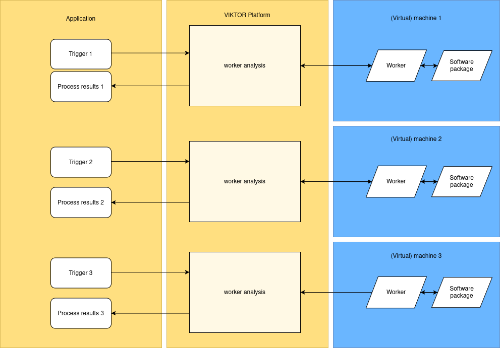

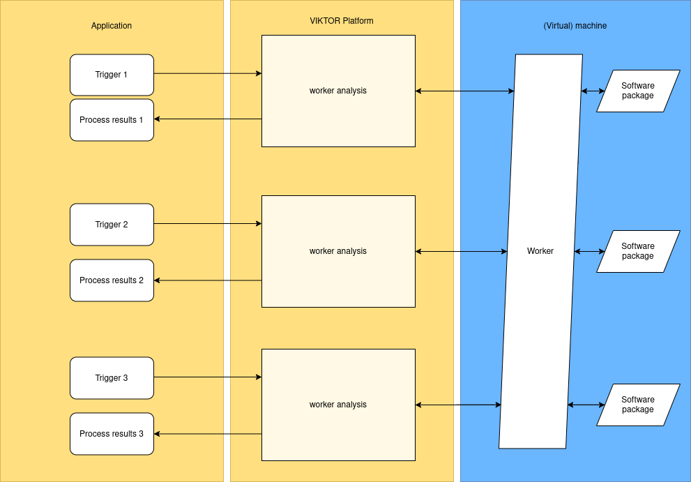

Multiple worker instances
The VIKTOR - worker interaction is configured such that it can easily be scaled up (or down). For example, the worker application can execute multiple instances (processes) of the software package.
Worker running multiple processes on single machine
Running parallel routines requires a worker version of at least v4.7.1 and should not be a generic worker.
A worker can also be executed multiple times across multiple different machines. Tasks are distributed randomly over the running worker instances, and thus multiple users can make use of the external integration at the same time.
Multiple workers across multiple machines

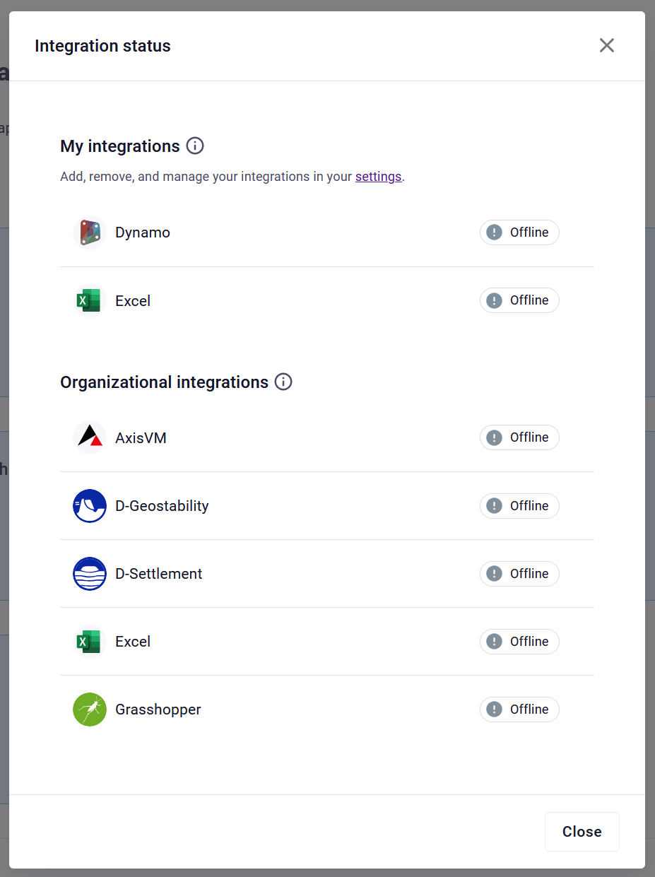

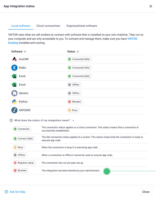

Worker status
Within the VIKTOR interface, a user can see the status of the connected workers via the icon in the top right corner:
This gives a user insights in:
  • which workers are connected and available
  • how many workers per external package are connected
  • whether a worker is currently running a job or not
Worker status
Note that the worker status does not provide information about licenses being available or not.
For personal workers, the editor also shows whether your worker is online or offline, and can take you directly to the right worker in VIKTOR Desktop to start it.

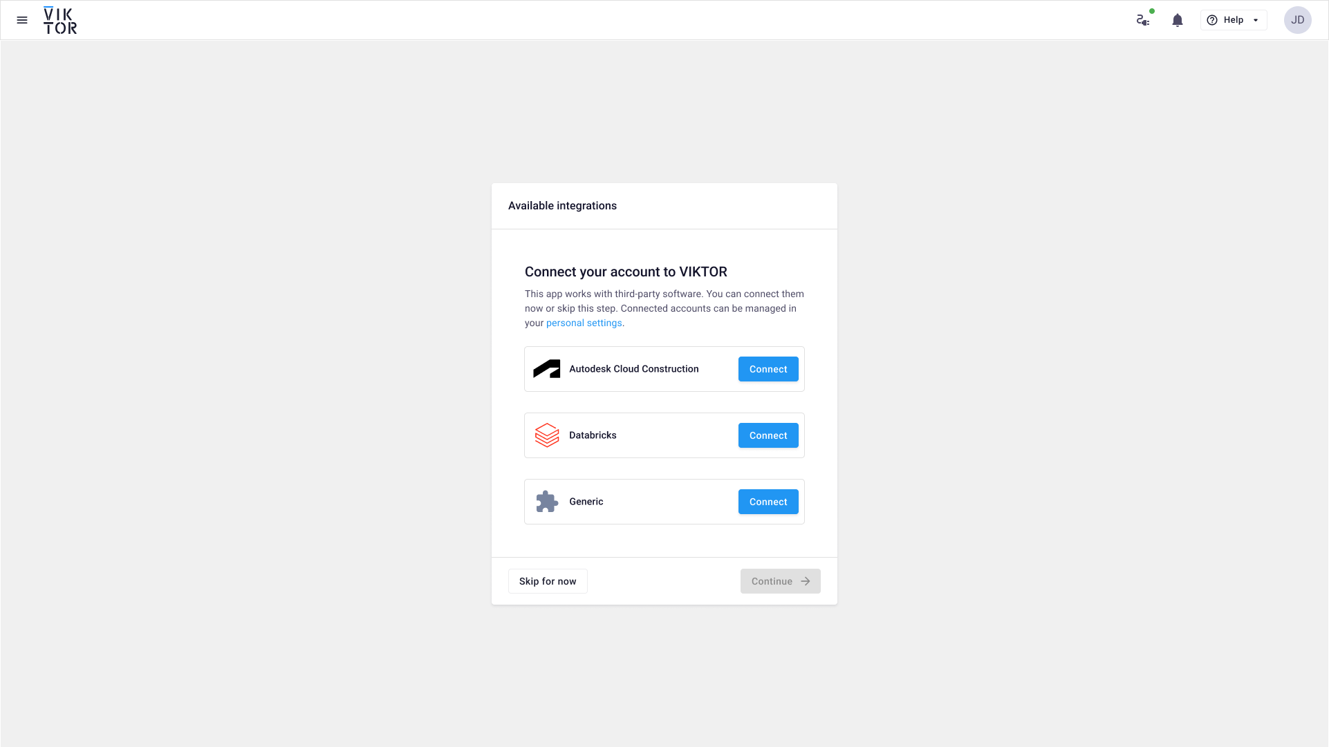

3. Using the integration by logging in (user)
With everything properly setup, the app is ready to be used. When a user enters the app for the first time, a pop-up will be shown, explaining that the user needs to login before the app can be used. The user logs in, thereby allowing the app to access the external software and the integration can be used. After a period of inactivity, the user needs to re-login to reactivate the integration. This duration is configurable per integration by the admin.
User asked to connect their account(s) when entering an app
