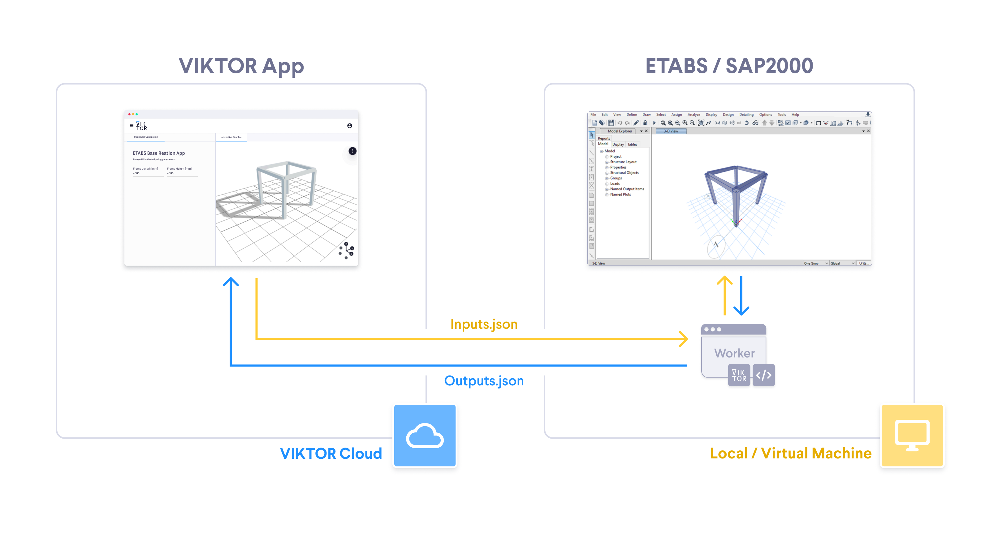

The worker
A worker is a program that connects the VIKTOR platform to third-party software running outside the platform. You can install the worker on your local machine or a remote server, but the CSI software must be installed where the worker is located. Your VIKTOR app will handle the communication between the web app and the worker as shown in the following diagram.
Here is what happens during the integration:
- The user enters input parameters in the VIKTOR UI.
- The
app.pyin the VIKTOR app sends a task to the worker - The worker (running on your local machine or a virtual machine) executes the task by using the CSI API.
- The worker returns the result of the calculation to your VIKTOR app.
- VIKTOR UI displays the result of the calculation.
The worker drives the real desktop application, so the machine it runs on needs a logged-in, interactive Windows session (a service running in Session 0 cannot start ETABS or SAP2000). The license must not prompt on startup either: nobody is there to answer a sign-in or activation dialog, so the app would only see a timeout.
