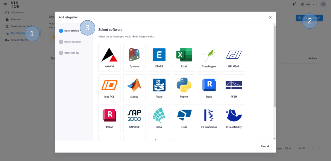

An organization worker connects software that runs on a machine managed by your organization, such as a virtual or remote machine, and is shared by the users of the workspace(s) you select.
You need to be an environment administrator in order to install an organization worker.
Navigate to the "Integrations" tab in the Administrator panel
Click "Add integration"
Follow the steps provided in the modal
3.1. Select
3.2. Select the workspace(s) the integration should be available to
3.3. Download the worker .msi (Microsoft Installer) and run it on the machine of choice
3.4. Copy the generated connection key and paste it when the installer asks for it. In the browser, you can now click Finish and continue in the installer.
Connection KeyThe generated connection key should be copied immediately as VIKTOR will not preserve this data for security reasons.
