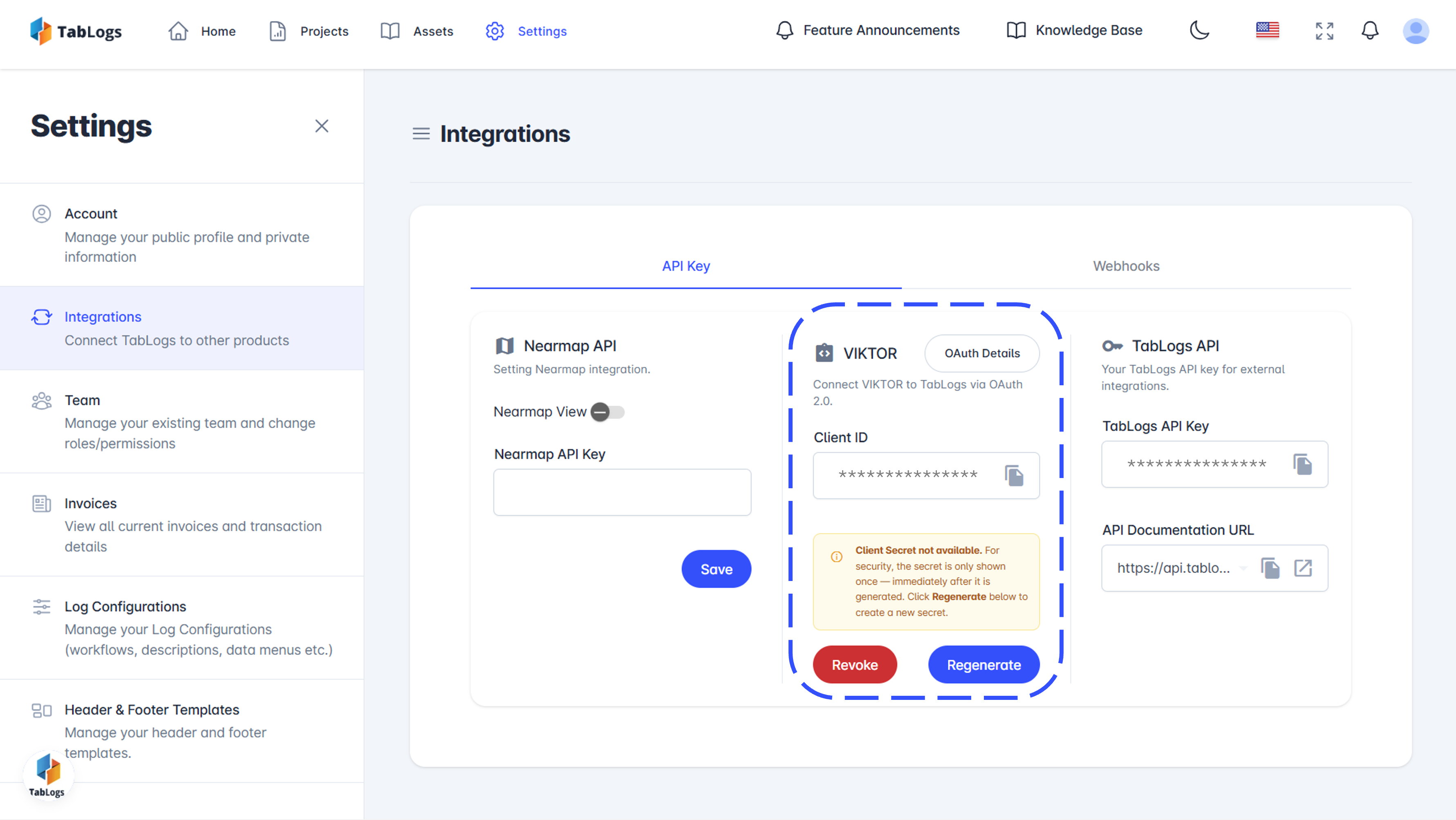

Open TabLogs Integrations and select the VIKTOR integration card, then open OAuth Details.
The TabLogs OAuth details provide the values needed to configure the integration in VIKTOR:
  • Client ID: A unique public identifier for your application
  • Client Secret: A confidential password used to authenticate your application
If the client secret is not available, click Regenerate to create a new secret.
The screenshot below shows the expected TabLogs OAuth details page.
Unlike other OAuth 2.0 integrations, TabLogs manages the redirect callback URL internally on their end. You do not need to configure or provide a callback URL when setting up the integration - TabLogs handles this automatically as part of their VIKTOR integration.

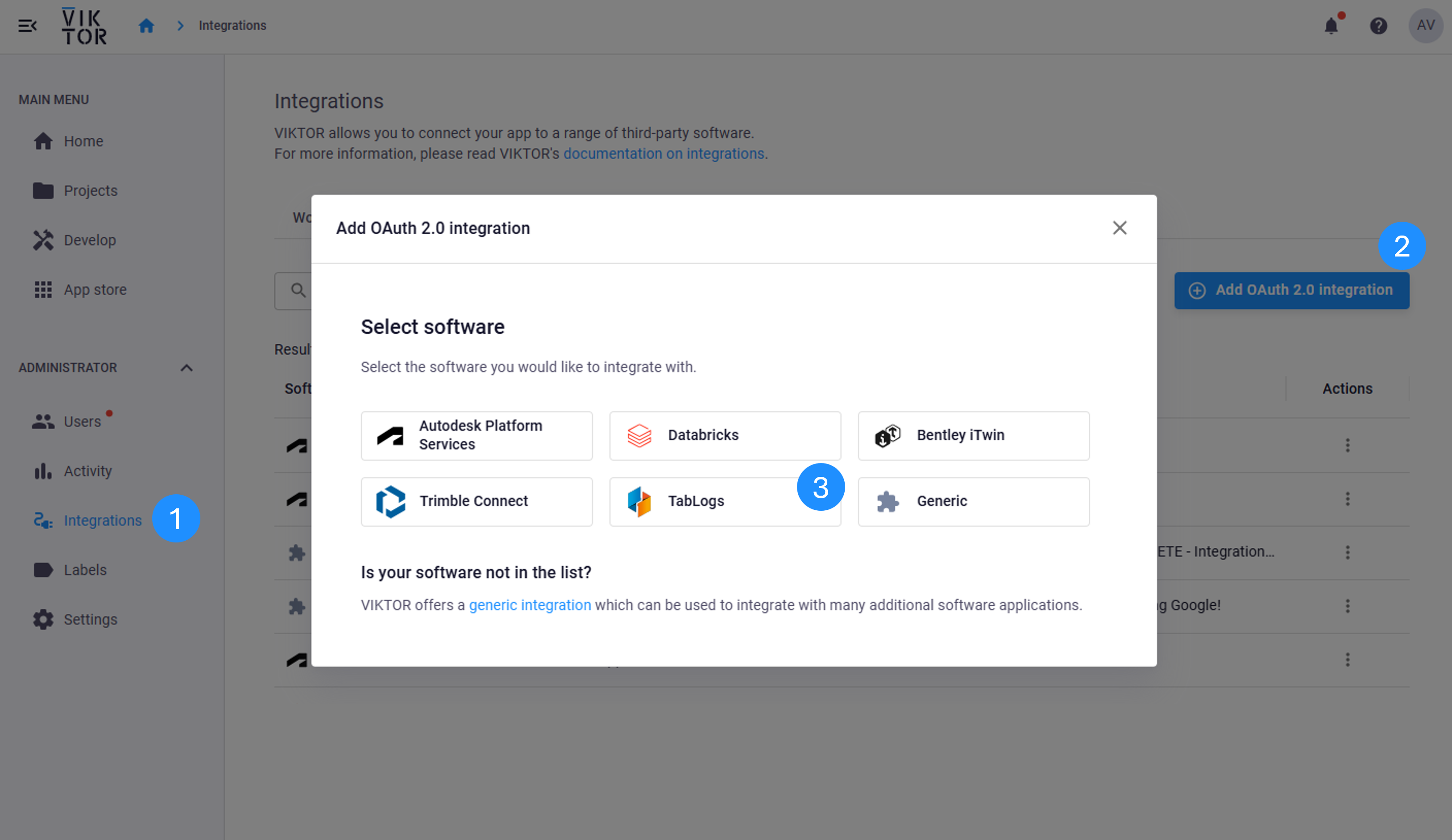

Creating an OAuth 2.0 integration (admin)
After receiving the Client ID and Client Secret, a VIKTOR admin can generate an OAuth 2.0 integration.
Start in the Administrator panel and create a new OAuth 2.0 integration with TabLogs as the selected software.
Open the OAuth 2.0 modal

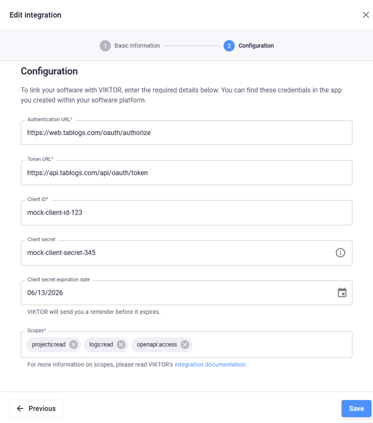

Then, in the Configuration step, use the TabLogs OAuth values shown below:
  • Authentication URL: https://web.tablogs.com/oauth/authorize
  • Token URL: https://api.tablogs.com/api/oauth/token
  • Client ID: <your TabLogs client id>
  • Client Secret: <your TabLogs client secret>
  • Client secret expiration date: <expiration date shown in TabLogs>
  • Scopes: projects:read logs:read openapi:access
TabLogs OAuth configuration in VIKTOR
info
The following scopes are used for this integration:
  • projects:read — allows access to available TabLogs projects.
  • logs:read — allows access to available TabLogs logs.
  • openapi:access — allows access to the TabLogs OpenAPI-backed API

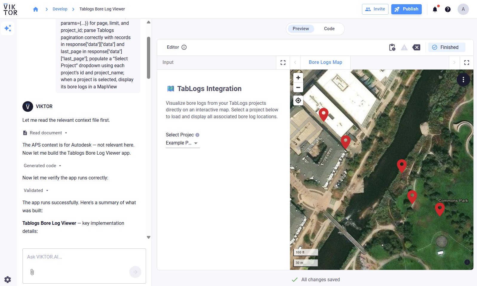

The App Builder provides a no-code approach to create applications with TabLogs integration. You can describe the app in natural language and let the App Builder generate the first version for you.
Use the following prompt to create an application that allows users to visualize the geographic location of bore logs (geotechnical boreholes) from a selected project:
Create a VIKTOR app that uses the OAuth2 integration “viktor-tablogs-integration” to fetch TabLogs projects from https://api.tablogs.com/openapi/v1.1.0/projects and bore logs from https://api.tablogs.com/openapi/v1.1.0/logs, using requests.get(..., params={...}) for page, limit, and project_id; parse TabLogs pagination correctly with records in response[“data”][“data”] and last_page in response[“data”][“last_page”]; populate a “Select Project” dropdown using each project’s id and project_name; when a project is selected, display its bore logs in a MapView to visualize their geographic locations.
A generated App Builder result can look like this:
TabLogs App Builder result

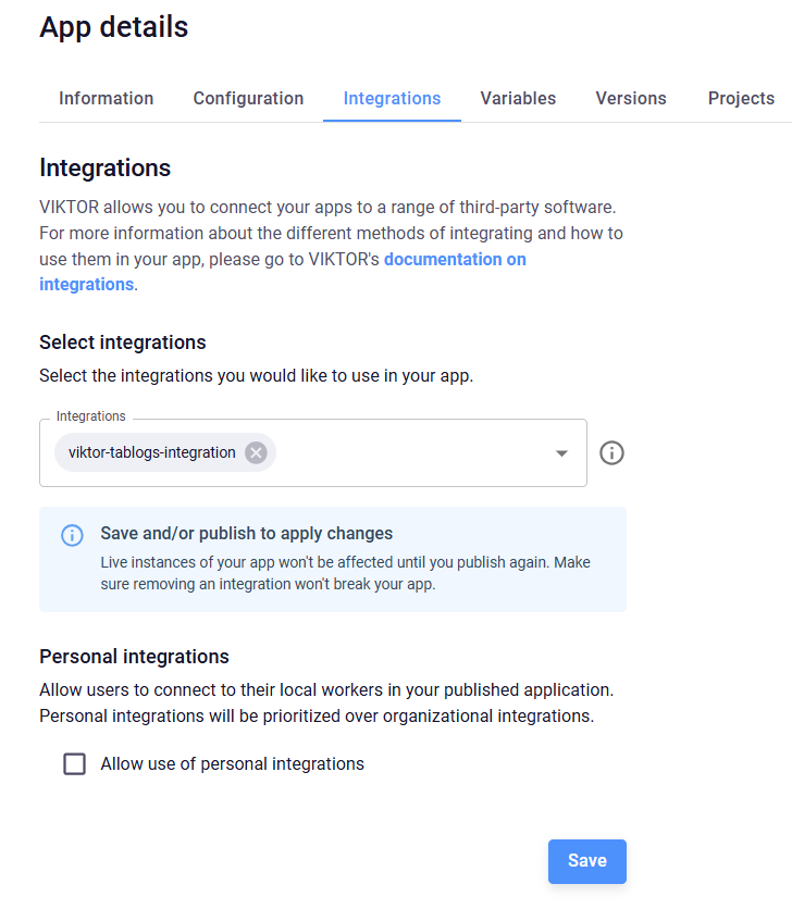

After submitting the prompt, the App Builder will ask you to connect the integration in the app settings:
  1. Click the App details button
  2. Select the integration name viktor-tablogs-integration
  3. Save the current selection
Assign the integration in App details
