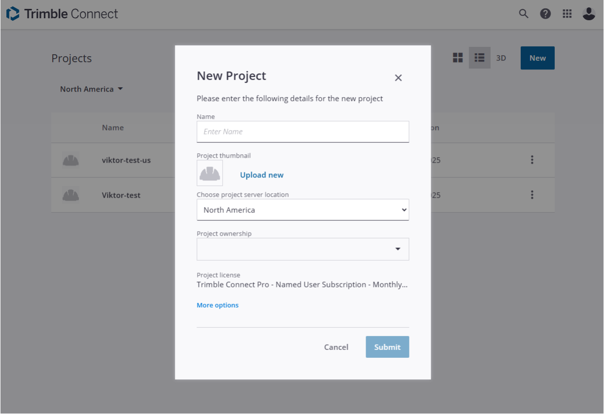

Creating a Project in Trimble Connect
In your Trimble Connect dashboard, you can manage or create a new project. This project will be connected to the VIKTOR application. If there is no project yet, you can click on "New" and fill in the form to create one.
Create App
Note
It is important to note the region where the application is hosted because the APIs to use depend on the region, as we will see later.

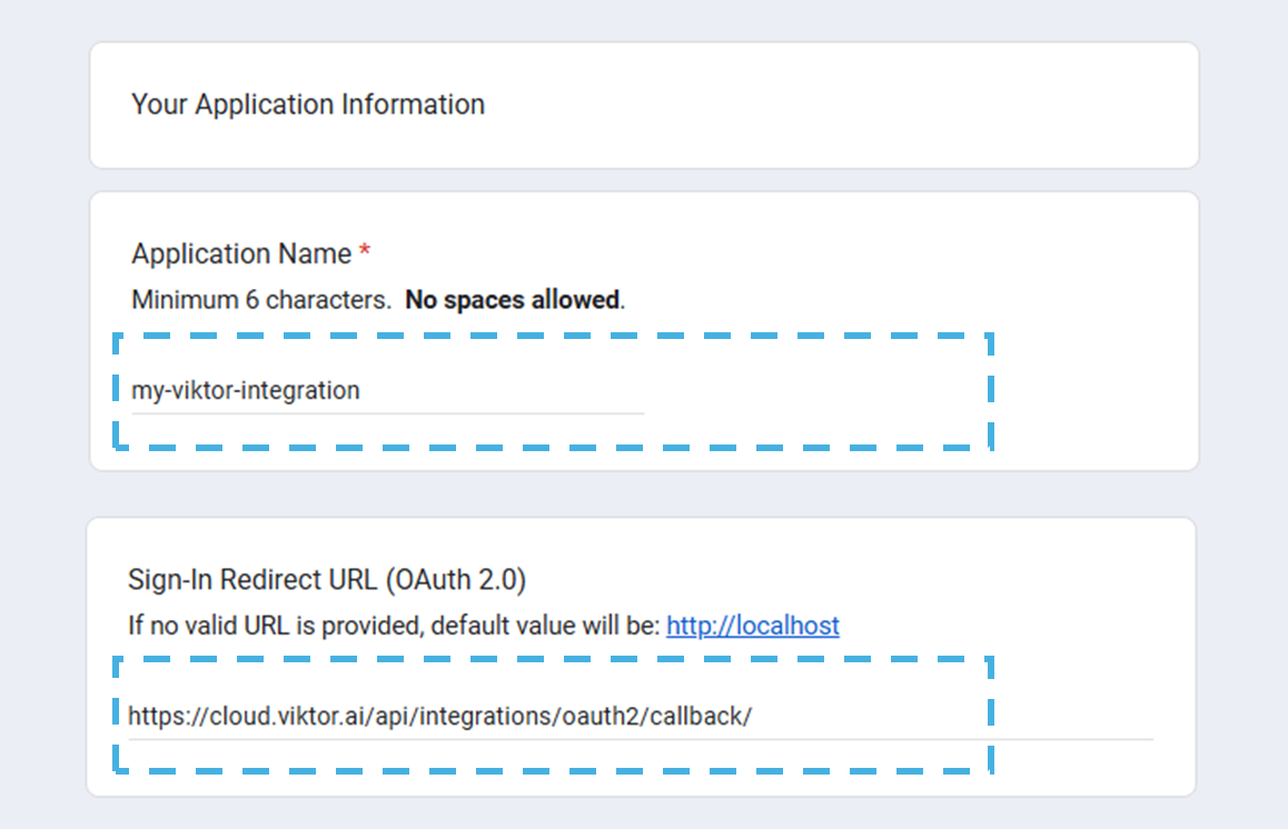

Request API Credentials
The administrator should go to the Trimble integrations page and request API credentials by filling out this form with your account information, the Application Name, and the Sign-In Redirect URL (OAuth 2.0).
The application name is important because it will be used to request an authorization token. Make sure to use a unique name. For demonstration purposes, the image below uses my-viktor-integration, but make sure to use something unique and specific for your case.
For the Sign-In Redirect URL (OAuth 2.0), you will provide a URL based on your VIKTOR environment.
<your-viktor-environment-url>/api/integrations/oauth2/callback/
Your environment URL should be https://cloud.viktor.ai/ or similar, depending on your organization. As an example, we will use https://cloud.viktor.ai/api/integrations/oauth2/callback/, but make sure to use the proper environment URL.

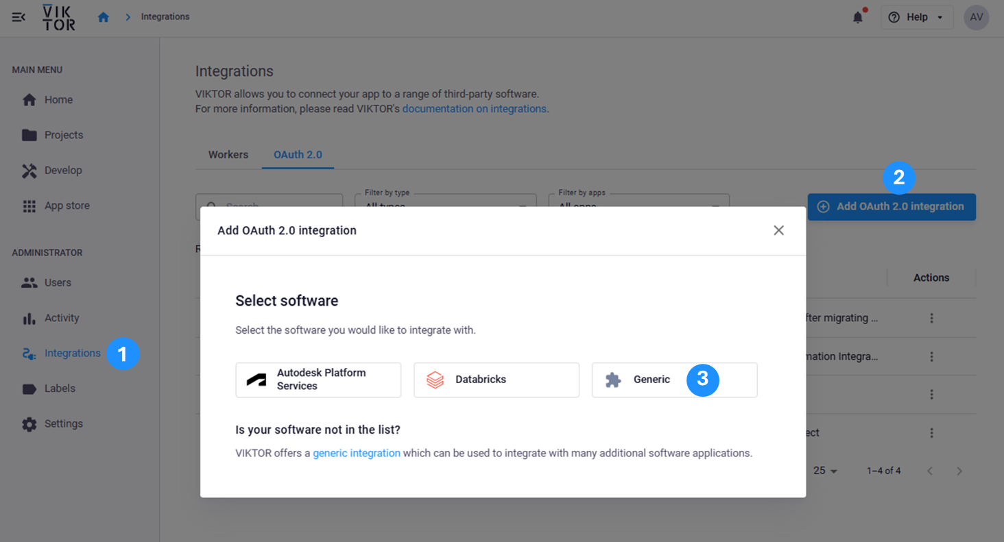

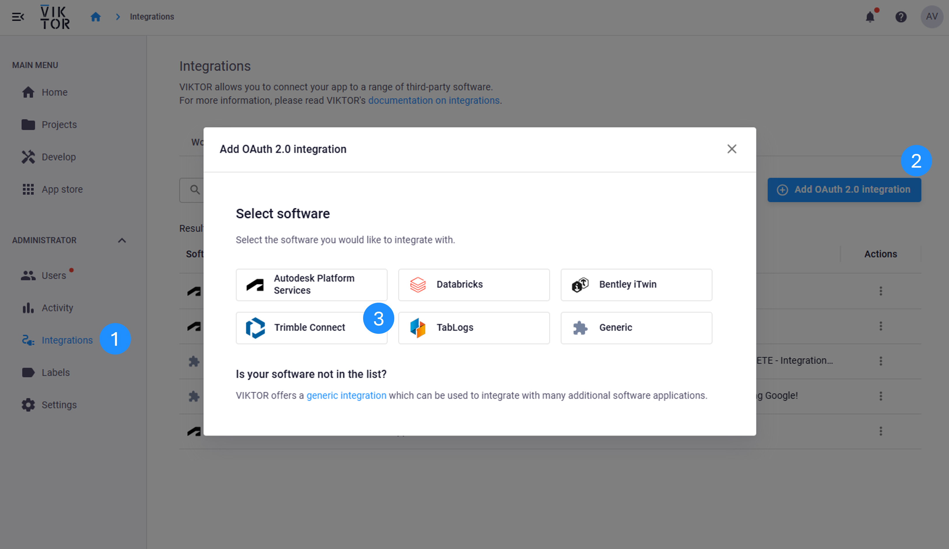

Creating an OAuth 2.0 Integration (Admin)
After receiving the Client ID and Client Secret, a VIKTOR admin can generate an OAuth 2.0 integration.
  1. Navigate to the Integrations tab in the Administrator panel.
  2. Select the OAuth 2.0 tab.
  3. Follow the steps in the modal:
    • Select Trimble Connect.
    • Go to the "Basic Information" tab and fill in the required fields, including the integration name, and select the applications that will use the integration. You can choose to limit the integration to specific apps or allow all apps in the environment to use it.

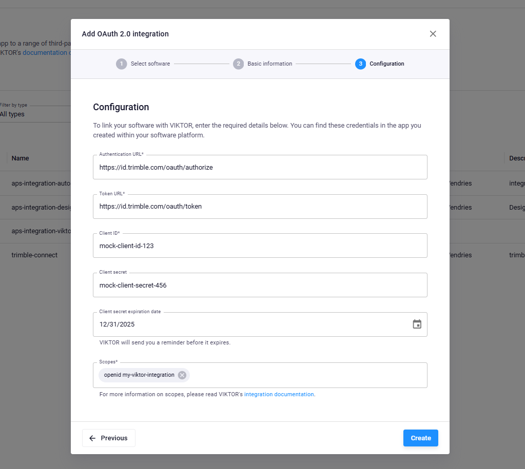

    • Then, in the "Configuration" tab, add the Authentication URL and Token URL as follows:
  4. Fill in the Client ID and Client Secret from the email you received from Trimble support.
  5. For the scope section, you will fill in:
openid <ApplicationName>
As defined in the previous step, for the "my-viktor-integration" application name, the scope will be openid my-viktor-integration.
VIKTOR Integration Configuration

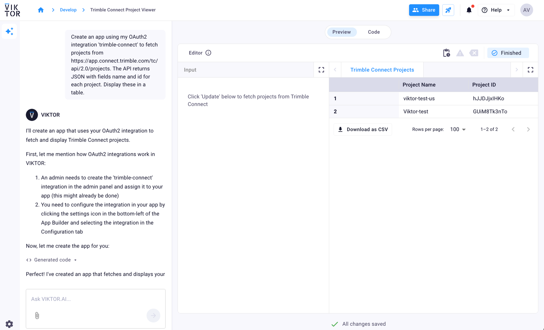

Using the App Builder
The App Builder provides a no-code approach to create applications with Trimble Connect integration. Simply provide a natural language prompt describing what you want to build, and the App Builder will generate the application for you.
To create an app that lists your projects from your Trimble Connect account, you can run the following prompt (make sure to replace 'my-viktor-integration' with the name of the integration you created in the previous steps):
Create an app using my OAuth2 integration 'my-viktor-integration' to fetch projects from:
URL: https://app.connect.trimble.com/tc/api/2.0/projects
The API returns JSON with fields 'name' and 'id' for each project. Display these in a table.

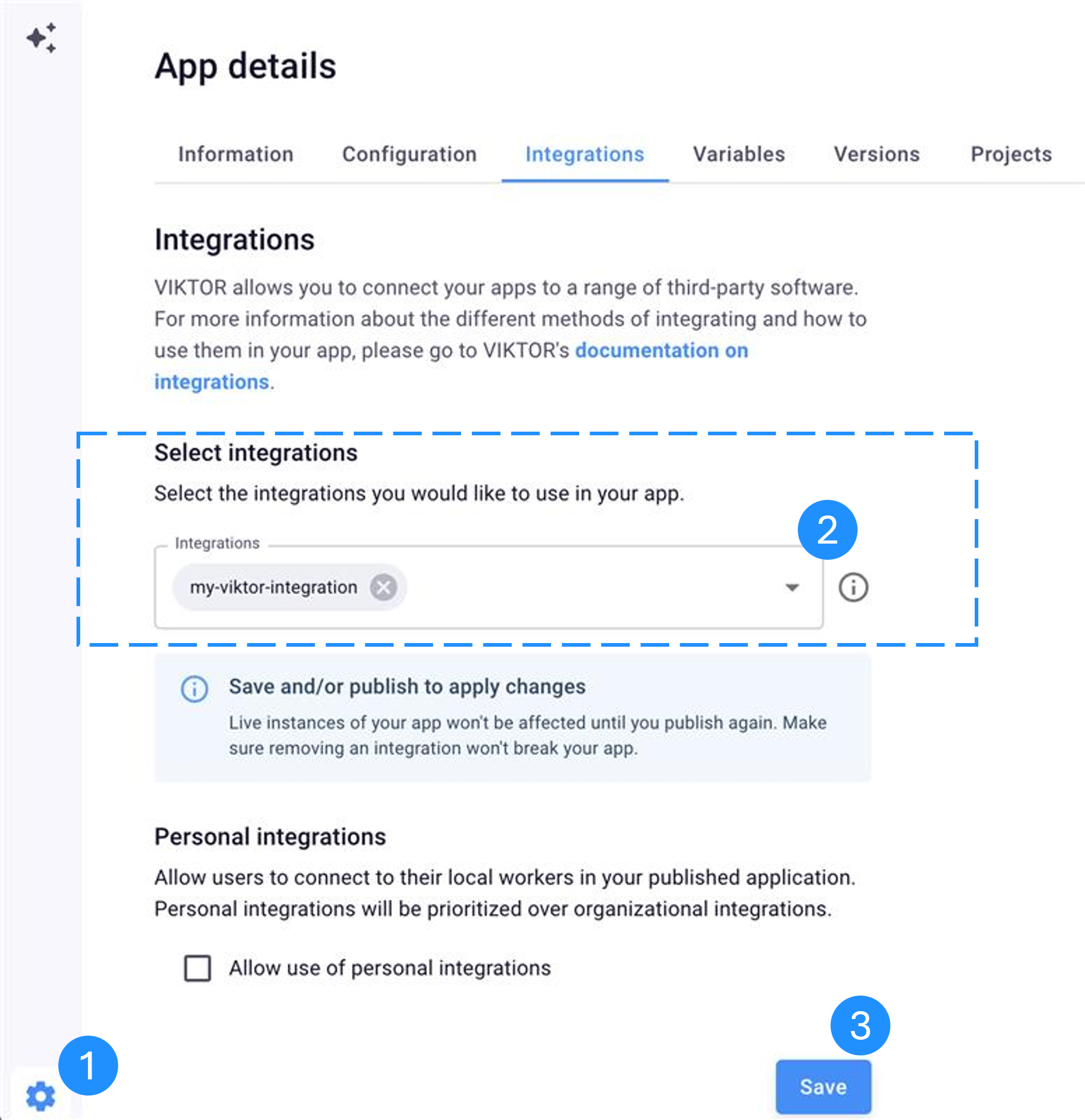

After submitting the prompt, the App Builder will ask you to set up the integration by following these 3 steps:
  1. Click the 'App details' button
  2. Select the integration name
  3. Save the current selection
App Builder Integration Configuration
Finally, the App Builder will generate an application that displays your Trimble Connect projects in a table after you log in. Note that in the example below, "my-viktor-integration" was replaced with a real integration name "trimble-connect".
App Builder Trimble Connect App
