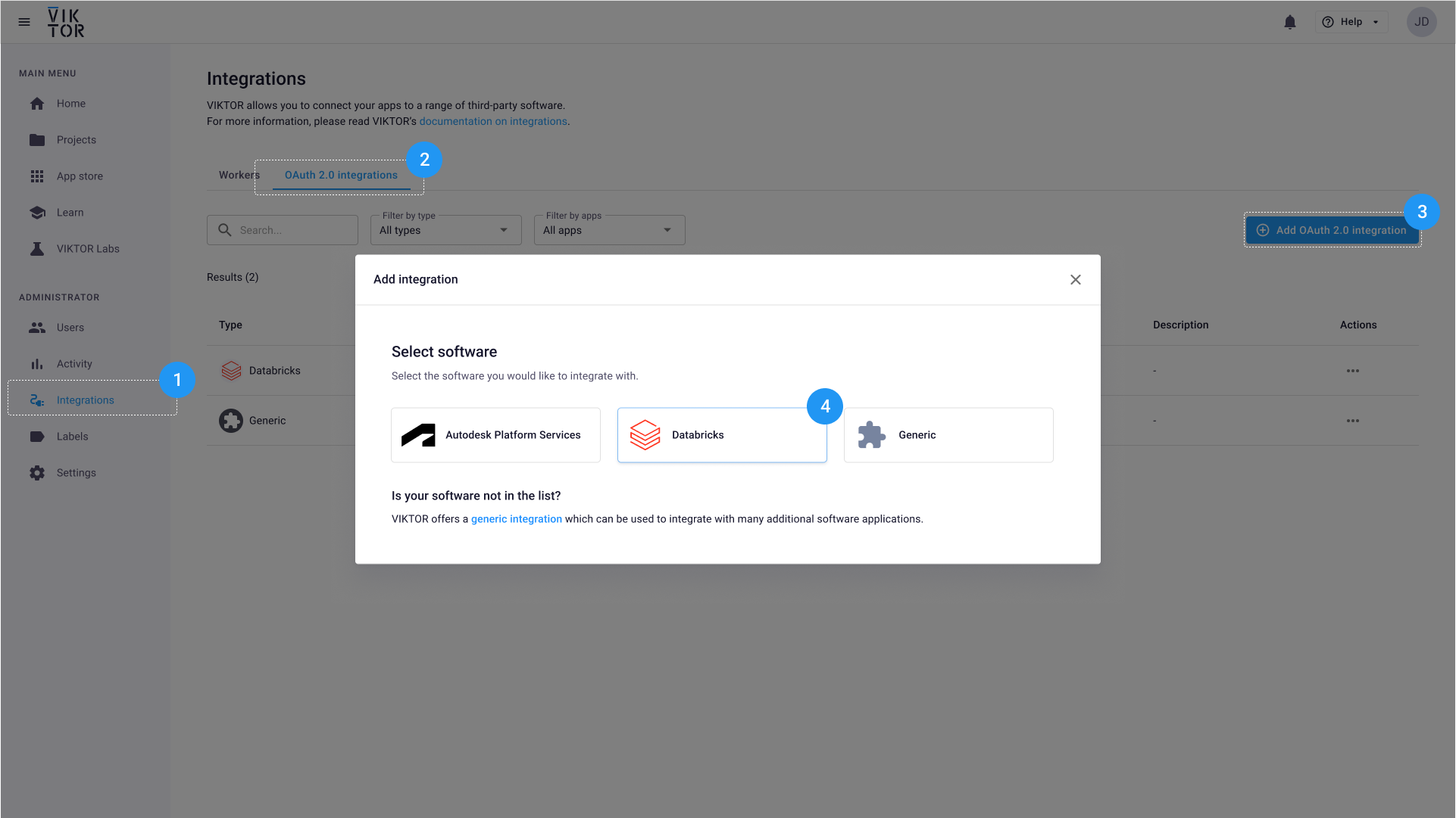

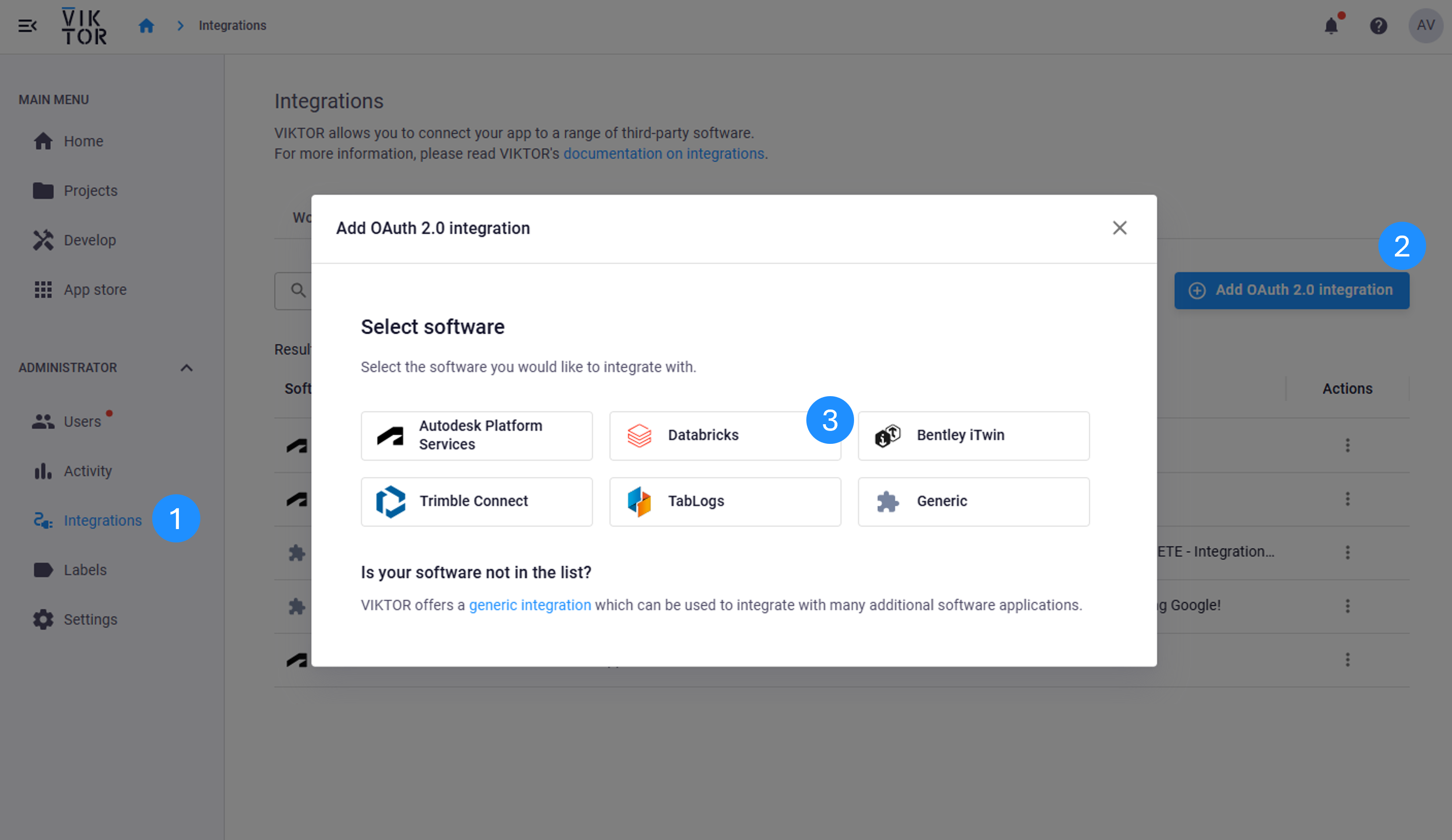

  1. Navigate to the "Integrations" tab in the Administrator panel and select the OAuth 2.0 integrations tab
  2. Click "Add OAuth 2.0 integration"
  3. Follow the steps provided in the modal
    1. Select "Databricks"

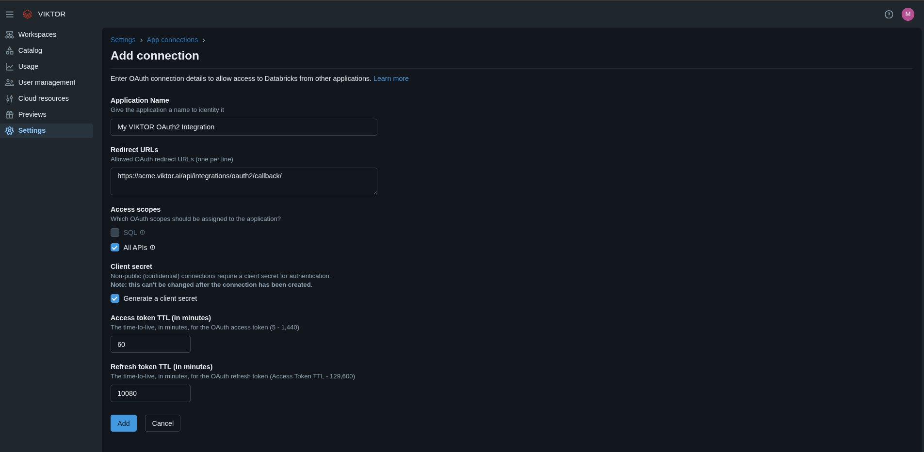

  1. For gathering the OAuth 2.0 integration information, navigate to Databricks account console of your organization and then navigate to the Settings. Account console is https://accounts.cloud.databricks.com/ if the Databricks setup does not live on Azure.
  2. Go to App Connections tab and add a new connection.
    1. Fill in basic connection information.
    2. Add <your-viktor-environment-url>/api/integrations/oauth2/callback/ to the allowed redirect urls.
    3. Select the scope for your integration and make sure to enable generate a client secret.

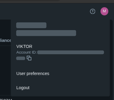

    • You can find your account id in your account console, profile section.

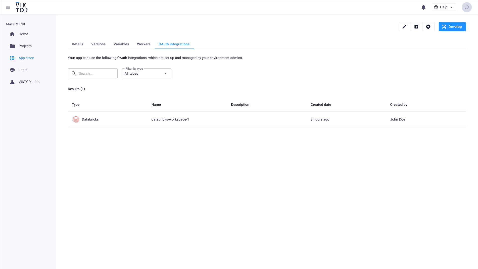

OAuth 2.0 integrations information in the app details page
First the integration is added in the config file, using the integration name. This is used by the platform to trigger a login button for the user when entering the app.
