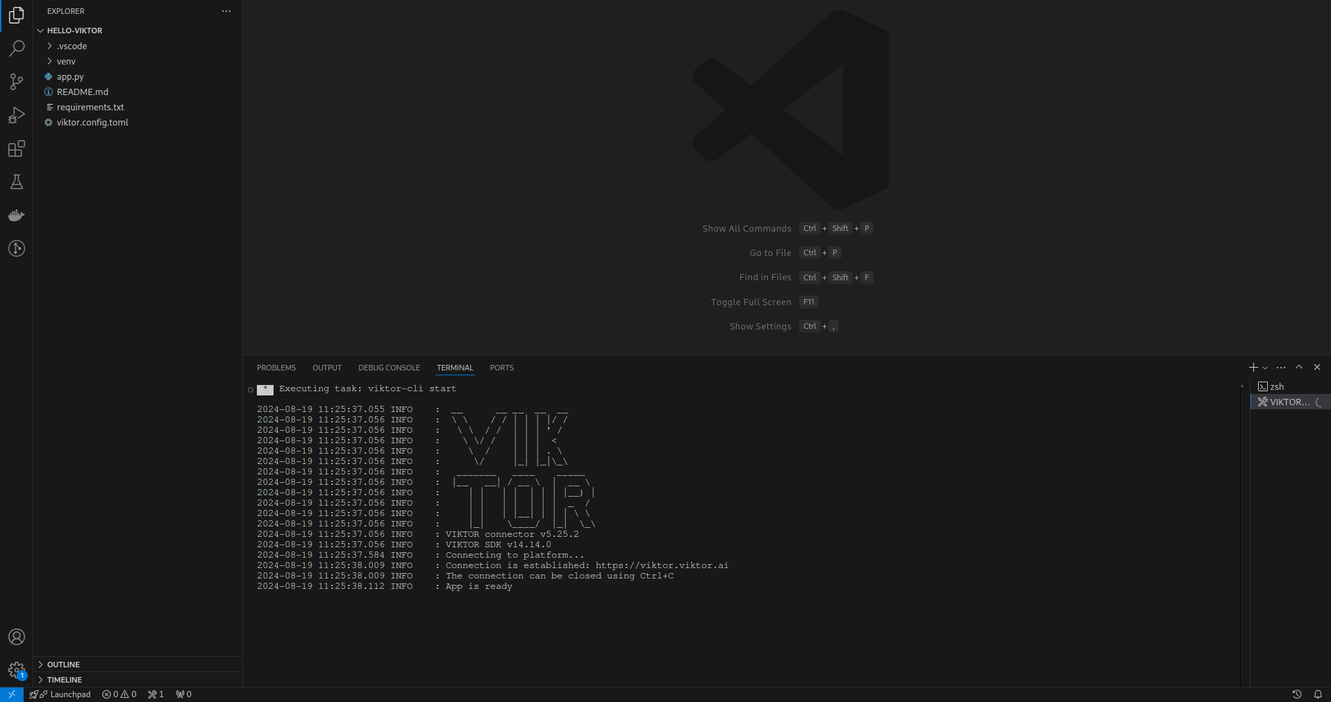

Once the command completes, open the hello-viktor folder in your code editor. From within the folder, install the app's dependencies and start it against the platform by running:
viktor-cli clean-start
This is shorthand for running viktor-cli install, viktor-cli clear, and viktor-cli start in sequence — the full first-time setup in one command.
Do not close the terminal as this will break the connection with your app.

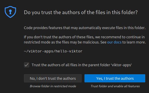

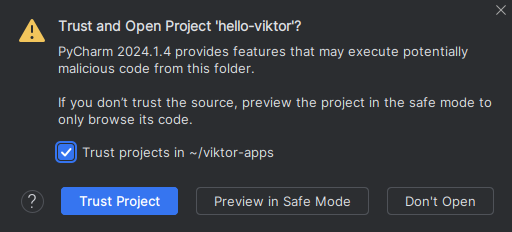

When I try to open the app code I see a warning message regarding trusting the project
You may first see a security warning about trusting projects located in the hello-viktor directory.
- PyCharm
- VS Code
Go ahead and tick the checkbox, followed by clicking the "Trust Project" button:

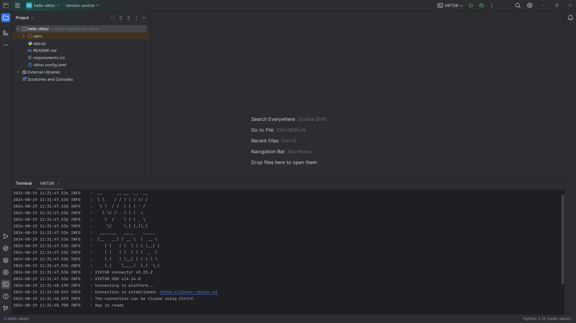

PyCharm should now open and look similar as shown below:

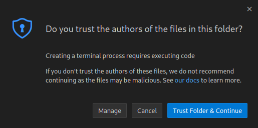

Go ahead and click the "Trust Folder & Continue"" button:
Subsequently you can click the checkbox to automatically trust all your future apps, and click "Yes, I trust the authors":
VS Code should now open and look similar as shown below:

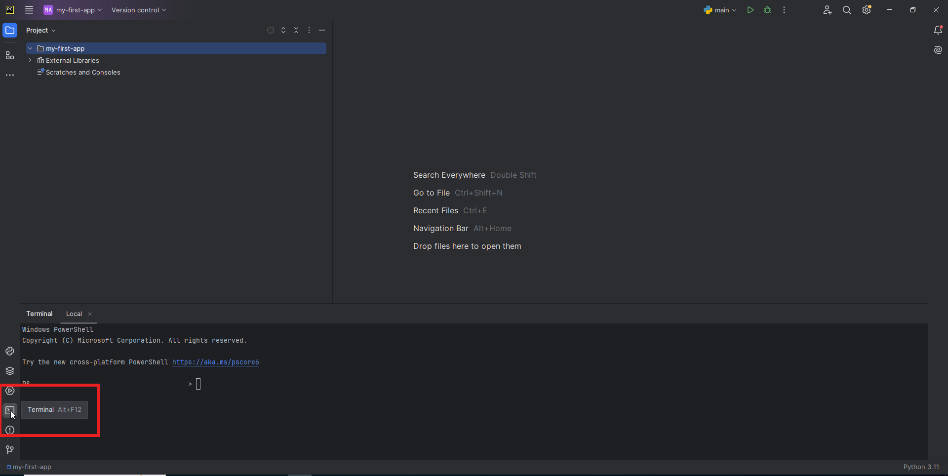

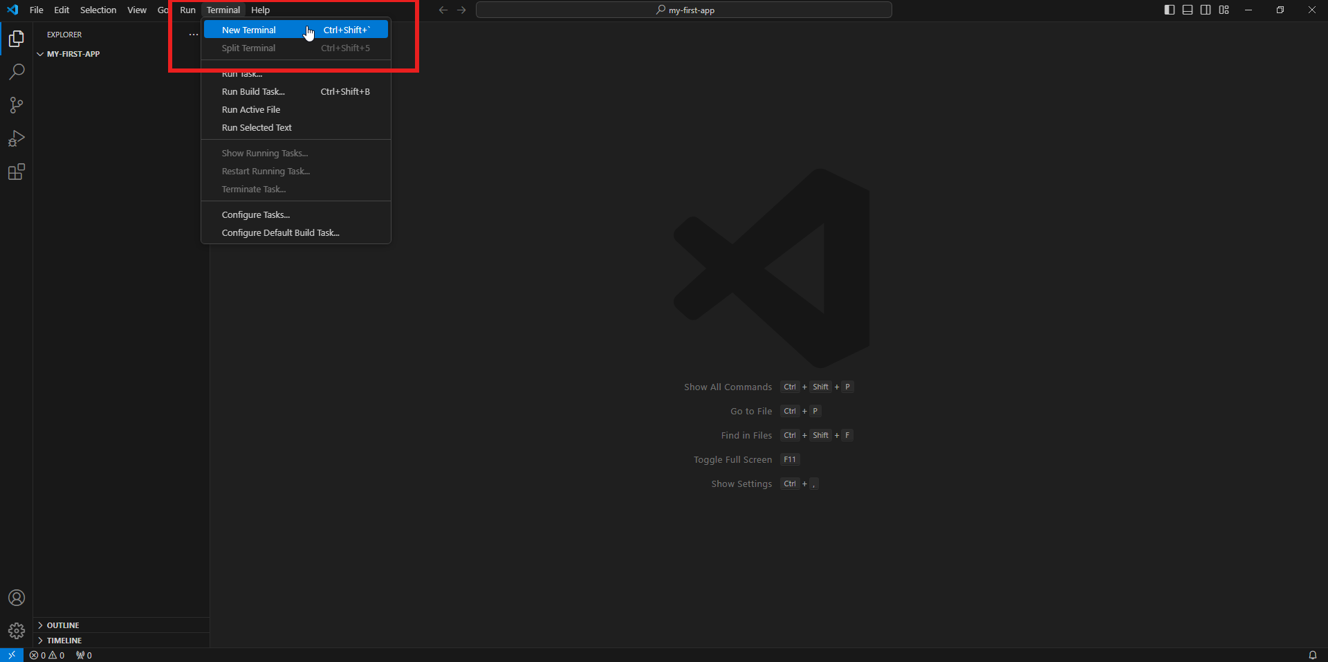

I cannot find my code editor's terminal
You can find the terminal as shown below:
- PyCharm
- VS Code

Each app has its own development workspace — this is where you can see what your app looks like in the browser and try out its functionality. You can enter the development workspace in two different ways:
- By clicking the 'Develop' button on the app card. The 3 latest apps you created are shown on the 'Develop' page. Alternatively, you can find all your apps by visiting the App store and selecting 'My apps'.
By following the URL that is shown in the terminal when your app code connects to the VIKTOR platform. This is a direct link to the corresponding development workspace.
INFO : Connecting to cloud.viktor.ai...
INFO : Connection is established (use Ctrl+C to close)
INFO :
INFO : Navigate to the link below to see your app in the browser
INFO : https://cloud.viktor.ai/workspaces/XXX/app
INFO :
INFO : App code loaded, waiting for jobs...
After entering the development workspace, you'll see your (still empty) app — ready to be built out in the next sections.

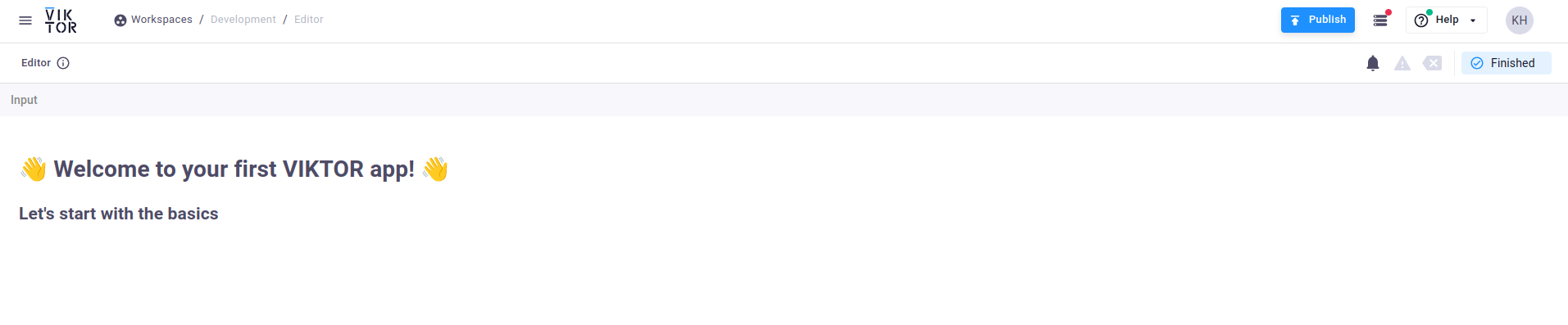

Let's replace the pass statement with a welcome message and a NumberField by copying the highlighted lines of code below. The vkt.Text widget displays formatted text in your app, and vkt.NumberField adds a numeric input. Your app.py file should look like this:
welcome = vkt.Text("# 👋 Welcome to your first VIKTOR app! 👋\n## Let's start with the basics")
length = vkt.NumberField("Length")
Save the app.py file. This action triggers a reload of your app. This reload is shown in the terminal.
If you made a coding mistake, errors will also be printed in the terminal.
INFO : Reloading app...
Refresh your webpage in the browser to see the "Length" input we just added:

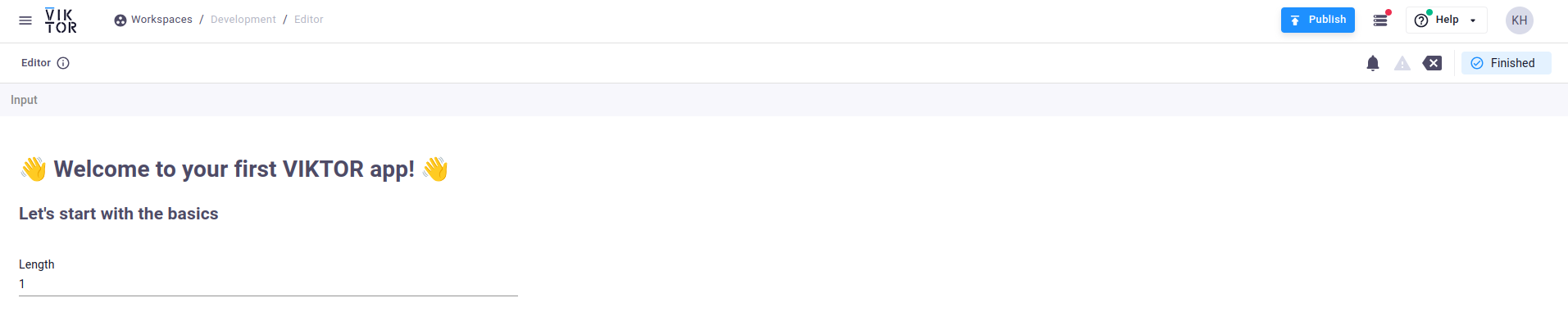

In many cases it is helpful to guide the user by providing a default value for the input fields. You can add a default value of 1 like this:
length = vkt.NumberField("Length", default=1)
Save the app.py file and refresh your webpage in the browser. Any pop-up regarding unsaved changes may be ignored.
After reloading, your app will show the default value:

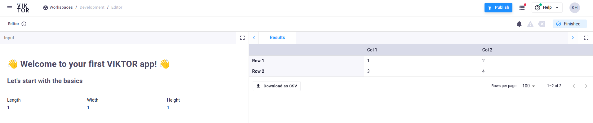

Save the app.py file and refresh your webpage in the browser:
Great, now let's connect the input values (obtained using the params argument) to the output. We will also rename the row and column headers to be more specific for our app:
width = vkt.NumberField("Width", default=1)
height = vkt.NumberField("Height", default=1)
@vkt.TableView("Results")
def results(self, params, **kwargs):
volume = params.length * params.width * params.height
surface = 2 * (params.length * params.width + params.length * params.height + params.width * params.height)
data = [
[volume, "m³"],
[surface, "m²"],
row_headers = ["Volume", "Surface"]
column_headers = ["Value", "Unit"]
return vkt.TableResult(data, row_headers=row_headers, column_headers=column_headers)
Well done! You can now adjust the dimensions of the cube and directly see its effect on the volume and outer surface area.
