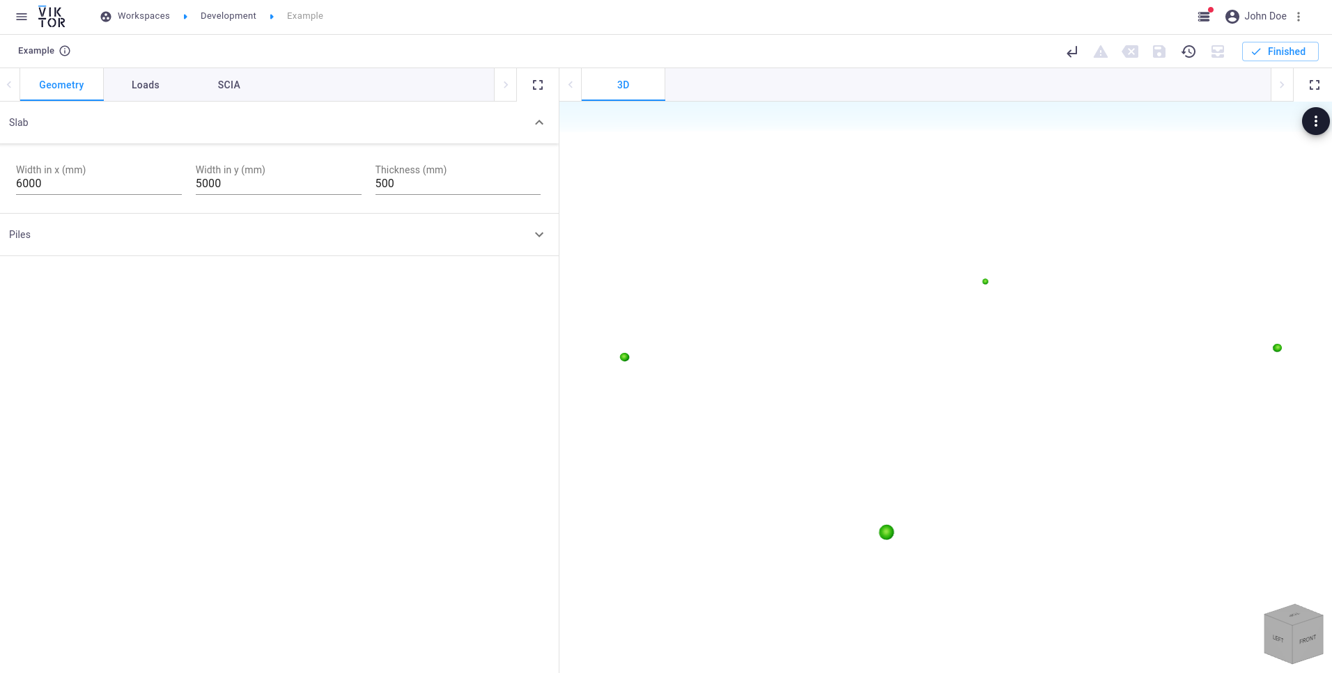

    Creating the corner nodes
    If we assume that one of the corner points is located in the origin, the other three corner point locations can easily be calculated using width_x and width_y. Open app.py and add the following code create_scia_model:
    def create_scia_model(self, params) -> vkt.scia.SciaModel:
    model = vkt.scia.SciaModel()
    STRUCTURE
    # create nodes at the slab corners
    width_x = params.geometry.slab.width_x * 1e-03
    width_y = params.geometry.slab.width_y * 1e-03
    n1 = model.create_node('n1', 0, 0, 0) # origin
    n2 = model.create_node('n2', 0, width_y, 0)
    n3 = model.create_node('n3', width_x, width_y, 0)
    n4 = model.create_node('n4', width_x, 0, 0)
    return model
    The corner nodes are defined in clockwise direction, since this order will be used later to create a 3D extrusion object.

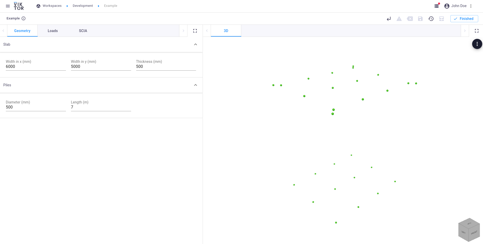

    While setting up a SCIA model in VIKTOR, the 3D visualization is a very helpful feature to verify that the written logic does indeed create the model as desired. Therefore, we will extend create_visualization_geometries to get and show the just created nodes. This can easily be done by calling the nodes attribute of the SciaModel:
    def create_visualization_geometries(self, params, scia_model):
    geometries = []
    for node in scia_model.nodes:
    node_obj = vkt.Sphere(vkt.Point(node.x, node.y, node.z), params.geometry.slab.width_y * 1e-05)
    node_obj.material = vkt.Material('node', color=vkt.Color(0, 255, 0))
    geometries.append(node_obj)
    return geometries
    Corner nodes

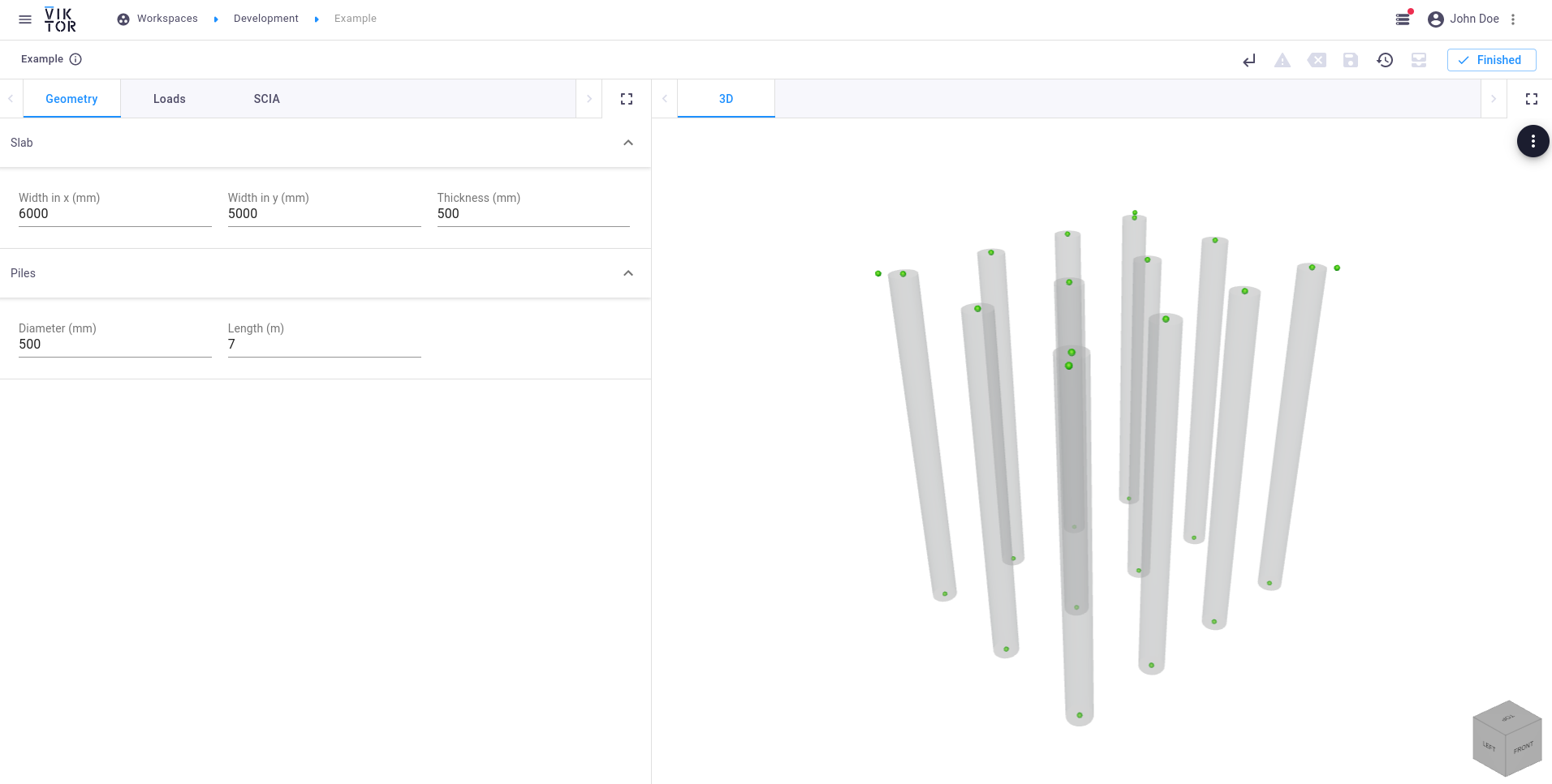

    For the visualization of the piles, a CircularExtrusion is used. This object needs a diameter and Line object which specifies the direction of the beam in terms of a start and end Point.
    # pile beams
    pile_diameter = params.geometry.piles.diameter * 1e-03
    for beam in scia_model.beams:
    point_top = vkt.Point(beam.begin_node.x, beam.begin_node.y, beam.begin_node.z)
    point_bottom = vkt.Point(beam.end_node.x, beam.end_node.y, beam.end_node.z)
    beam_obj = vkt.CircularExtrusion(pile_diameter, vkt.Line(point_top, point_bottom))
    beam_obj.material = vkt.Material('beam', roughness=1, opacity=0.3)
    geometries.append(beam_obj)
    Pile beams

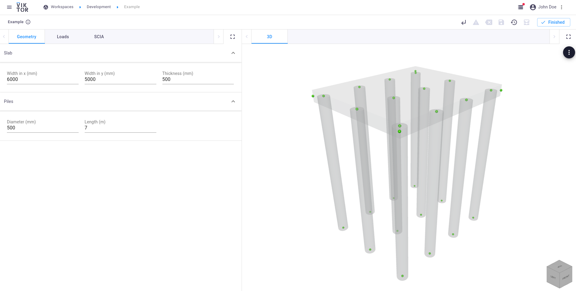

    Again we can verify the position and dimensions of the created slab by means of visualization:
    corner_points = [
    vkt.Point(scia_model.nodes[0].x, scia_model.nodes[0].y, scia_model.nodes[0].z),
    vkt.Point(scia_model.nodes[1].x, scia_model.nodes[1].y, scia_model.nodes[1].z),
    vkt.Point(scia_model.nodes[2].x, scia_model.nodes[2].y, scia_model.nodes[2].z),
    vkt.Point(scia_model.nodes[3].x, scia_model.nodes[3].y, scia_model.nodes[3].z),
    thickness = params.geometry.slab.thickness * 1e-03
    slab_obj = vkt.Extrusion(corner_points, vkt.Line(vkt.Point(0, 0, -thickness/2), vkt.Point(0, 0, thickness/2)))
    slab_obj.material = vkt.Material('slab', roughness=1, opacity=0.3)
    geometries.append(slab_obj)
    Slab

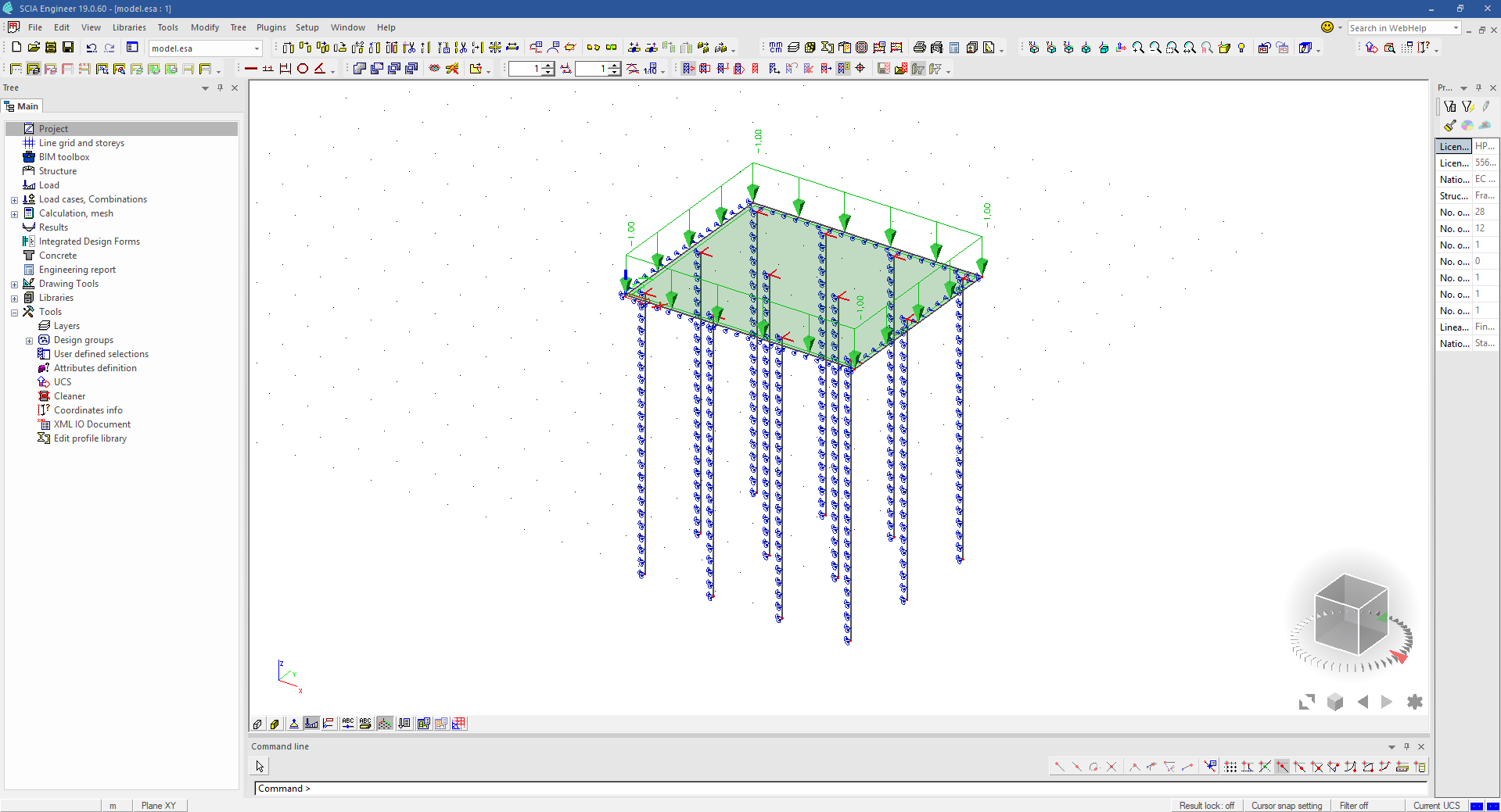

    Downloading the SCIA model
    It is always helpful to generate the XML representation of the SCIA model and to manually load this input in the SCIA interface. This will help in verifying that, for example, all the loads are defined correctly in terms of placement and magnitude. In the app we will add a feature to download the necessary files.
    In order to be able to view the created model in the SCIA interface, the following three files are needed:
    1. Empty SCIA model (*.esa)
    2. Definition file (*.def)
    3. Input file (*.xml)
    Now let's fill the download methods that we defined earlier in Foundation:

    Viewing the model in SCIA
    caution
    SCIA 19.0 is required if using the example file.
    When the files are obtained, the empty .esa model can be opened in SCIA. This model will now be updated with the created input .xml file. In SCIA Engineer:
    1. Click on File -> Update -> XML file
    2. Select the test.xml file
    It is important that the .xml and the .def files are located in the same directory, and the filename of the .def should not be changed. If this name is changed, make sure to also change the reference to this .def file in the input .xml file.
    The updated SCIA model should look like this:

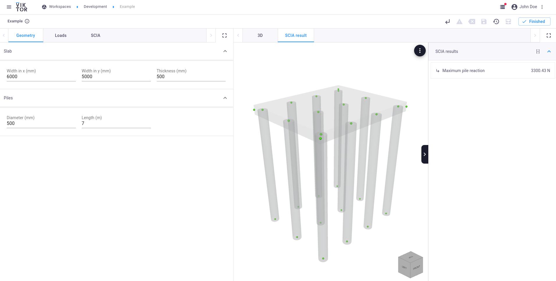

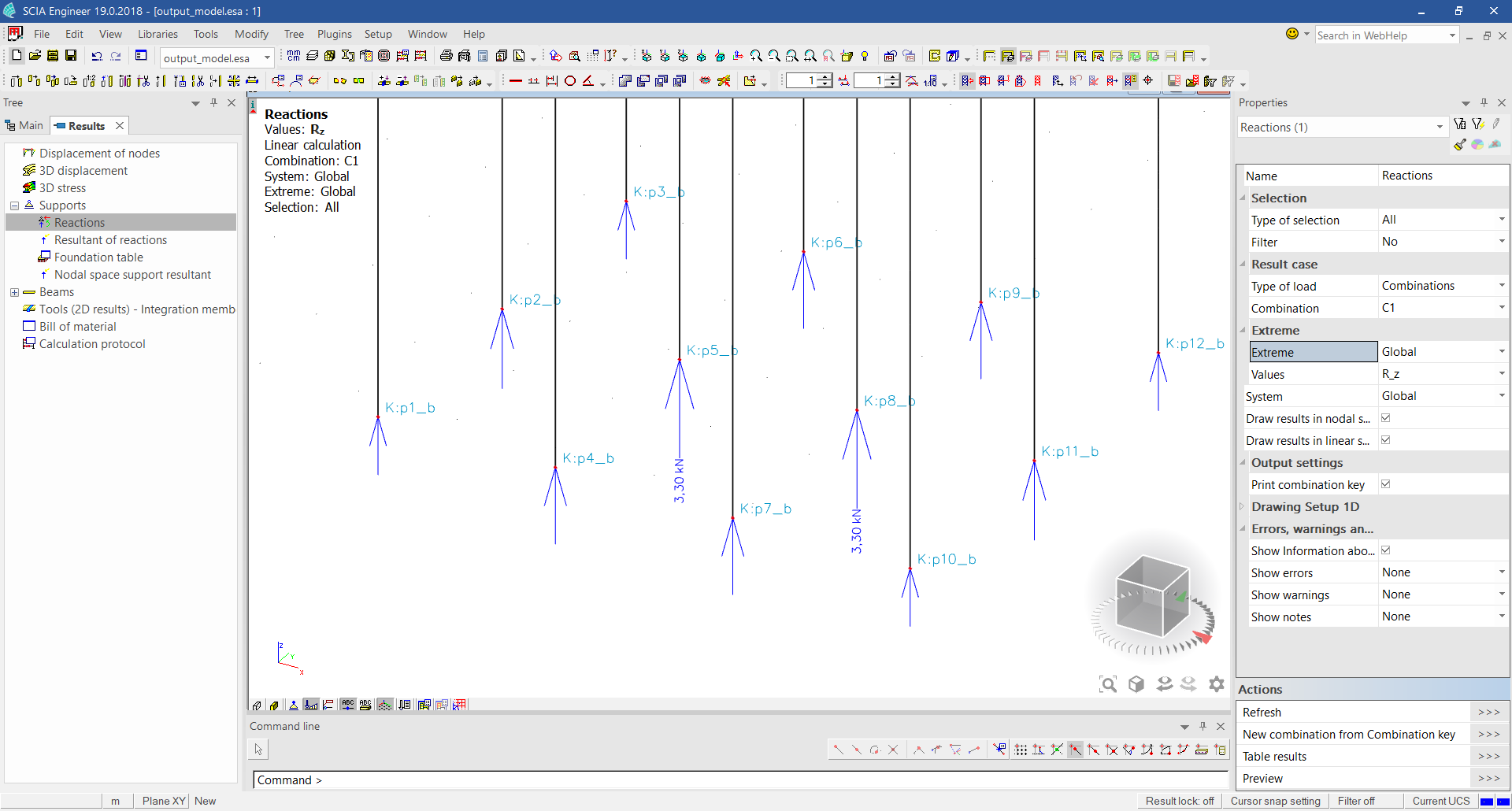

    The pile reactions as seen from within the SCIA interface show a maximum of 3.3 kN (depending on your load input):
    SCIA analysis result in SCIA
    From the result obtained in VIKTOR we can validate that we indeed obtained the maximum reaction force of this load combination:
    SCIA analysis result obtained in VIKTOR
