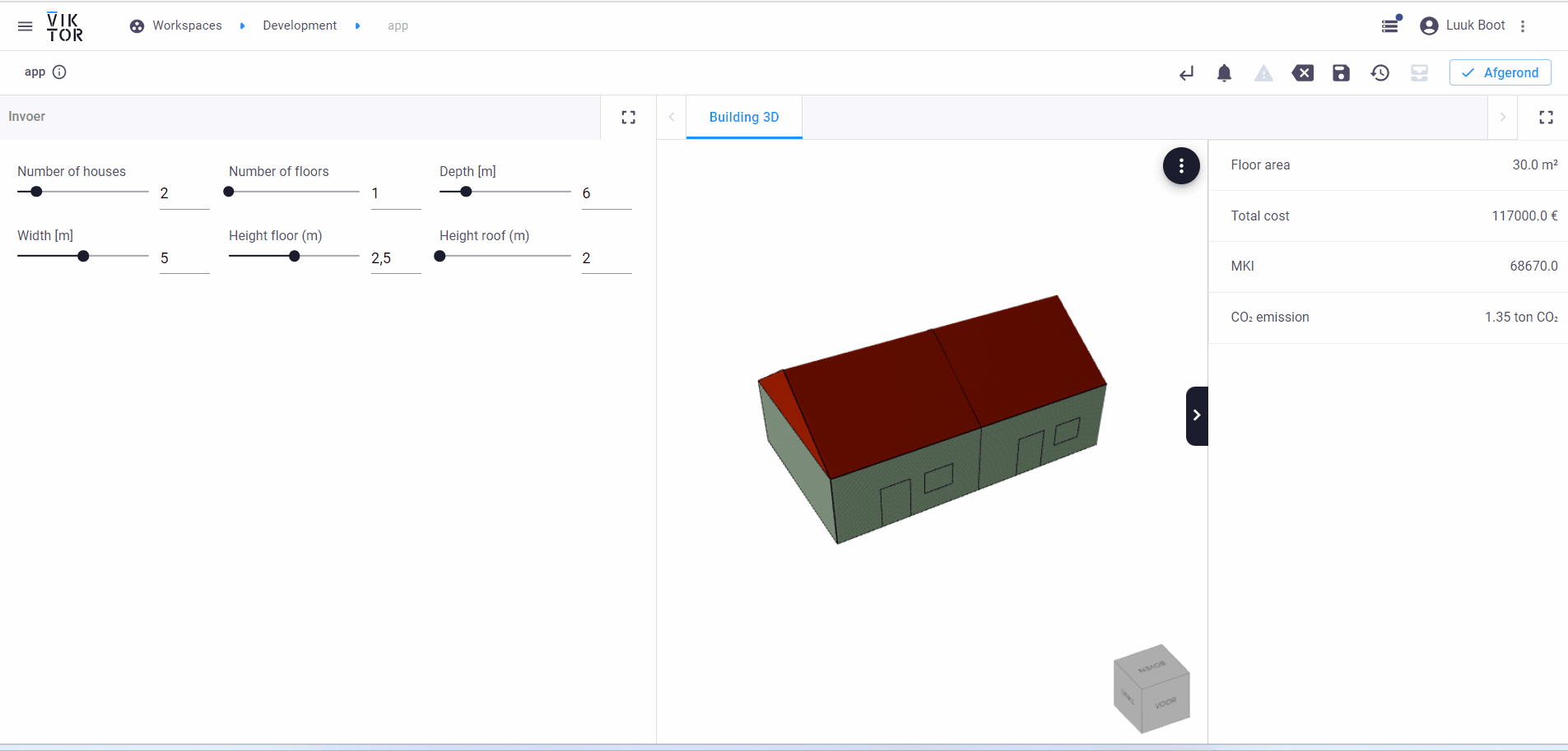

    3. Create a GeometryView with mocked output files
    In this section we will add a GeometryView to display the house's geometry. However, for now, we will use a mocked output file. In section 7 we will create the json file using the Dynamo script.
    Before you continue, download the mocked output file here and save it in your app folder next to app.py. To visualize the mocked output add a GeometryView method to your Controller class, see code below:
    intro = vkt.Text("# 3D Dynamo app \n This app parametrically generates and visualises a 3D model of a house using a Dynamo script. \n\n Please fill in the following parameters:")
    number_of_houses = vkt.NumberField("Number of houses", max=8.0, min=1.0, variant='slider', step=1.0, default=3.0)
    number_of_floors = vkt.NumberField("Number of floors", max=5.0, min=1.0, variant='slider', step=1.0, default=2.0)
    depth = vkt.NumberField("Depth", max=10.0, min=5.0, variant='slider', step=1.0, default=8.0, suffix="m")
    width = vkt.NumberField("Width", max=6.0, min=4.0, variant='slider', step=1.0, default=5.0, suffix="m")
    height_floor = vkt.NumberField("Height floor", max=3.0, min=2.0, variant='slider', step=0.1, default=2.5, suffix='m')
    height_roof = vkt.NumberField("Height roof", max=3.0, min=2.0, variant='slider', step=0.1, default=2.5, suffix='m')
    @staticmethod
    def update_model(params) -> tuple[vkt.File, vkt.dynamo.DynamoFile]:
    """This method updates the nodes of the Dynamo file with the parameters
    from the parametrization class."""
    # Create a DynamoFile object using the sample file
    file_path = Path(__file__).parent / "dynamo_model_sample_app.dyn"
    dyn_file = vkt.dynamo.DynamoFile(vkt.File.from_path(file_path))
    # Update the Dynamo file with parameters from user input
    dyn_file.update("Number of houses", params.number_of_houses)
    dyn_file.update("Number of floors", params.number_of_floors)
    dyn_file.update("Depth", params.depth)
    dyn_file.update("Width", params.width)
    dyn_file.update("Height floor", params.height_floor)
    dyn_file.update("Height roof", params.height_roof)
    # Generate updated file
    input_file = dyn_file.generate()
    return input_file, dyn_file
    @vkt.GeometryView("Mocked 3d model", x_axis_to_right=True)
    def mocked_geometry_view(self, params, **kwargs):
    # Step 1: Update model
    input_file, dynamo_file = self.update_model(params)
    # Step 2: Running analysis
    file_path = Path(__file__).parent / "Mocked_3d_model.json"
    threed_file = vkt.File.from_path(file_path)
    # Step 3: Processing geometry
    glb_file = vkt.dynamo.convert_geometry_to_glb(threed_file)
    return vkt.GeometryResult(geometry=glb_file)
    Let us go through the above mentioned logic:
    1. Update the Dynamo file with the update_model method(see section 2)
    2. For now we are using a mocked file, instead of running the analysis in Dynamo. The mocked file can be downloaded here. In section 7 it is explained how to create the json file using the Dynamo script.
    3. With the helper function convert_geometry_to_glb, you can convert the json file to a GLB file, which can directly be visualized in a GeometryView.
    4. Refresh your app in the browser, and you should see a 3D model of a house.

    @vkt.GeometryAndDataView("Building 3D", duration_guess=5, x_axis_to_right=True)
    def geometry_and_data_view(self, params, **kwargs):
    """Run an analysis using Dynamo and visualize the geometry and data"""
    files = [
    ('input.dyn', input_file),
    analysis = vkt.dynamo.DynamoAnalysis(files=files, output_filenames=["output.xml", "geometry.json"])
    analysis.execute(timeout=60)
    geometry_file = analysis.get_output_file('geometry.json', as_file=True)
    glb_file = vkt.dynamo.convert_geometry_to_glb(geometry_file)
    # Step 4: Process numerical output
    output_file = analysis.get_output_file('output.xml', as_file=True)
    data_group = self.convert_dynamo_file_to_data_items(dynamo_file, output_file)
    return vkt.GeometryAndDataResult(geometry=glb_file, data=data_group)
    The steps in geometry_and_data_view explained:
    1. Update the Dynamo file with the update_model method (see section 2)
    2. We use the DynamoAnalysis to run the Dynamo script. The executable_key in the example above refers to the "dynamo" command in the configuration file of the worker. For more information on how to configure the worker, refer to next section.
    3. Processing the geometry, the .json file can be obtained with the get_ouput_file method. With the helper function convert_geometry_to_glb, you can convert it to a GLB type file, which can directly be visualized in a GeometryAndDataView.
    4. Processing geometry, the .xml file can be obtained with the get_ouput_file. method. With the static method convert_dynamo_file_to_data_items, you can convert the .xml file to a Datagroup, which can be directly visualized in GeometryAndDataView.
    files = [('input.dyn', input_file)]
