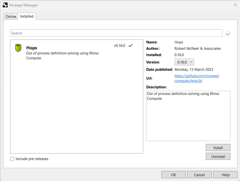

    Install Hops plugin
    Hops is a plugin for Grasshopper, which will be used to make it possible to call the Grasshopper script externally, using a local Rhino Compute server. Follow these steps to install Hops:
    1. Install Hops via the Package Manager in Rhino (type PackageManager on the Rhino command line and search for "Hops")

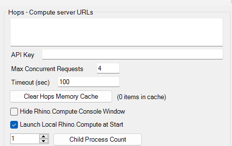

    1. Make sure Rhino Compute will be launched at start up. In Grasshopper, go to File -> Preferences and check the following settings:
    We recommend to uncheck Hide Rhino.Compute Console Window, because you can then easily see if Rhino Compute is running and debug when necessary.

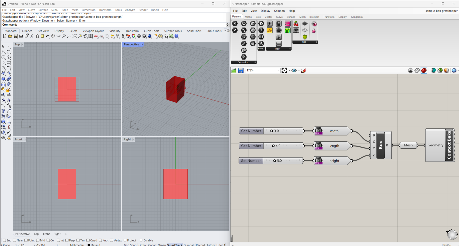

    (optional) Check out Grasshopper model
    Before we start building the app, you might be curious to know what kind of Grasshopper model we will be integrating. If you want to check out the Grasshopper model, open the Grasshopper file (sample_box_grasshopper.gh) with the Grasshopper plugin and this should lead to the following view:
    Let's take some time to check out what is happening in the Grasshopper script:
    1. Three Hops input parameters (width, length and height) are defined based on the Get Number component of Hops.
    2. A simple box is created based on the width, length and height, which is subsequently meshed.
    3. The mesh is baked into Rhino using the Context Bake component of Hops.
    If you change the input parameters, you will see that a box is drawn in Rhino. With this setup, we are ready to run this Grasshopper file from a Python script.

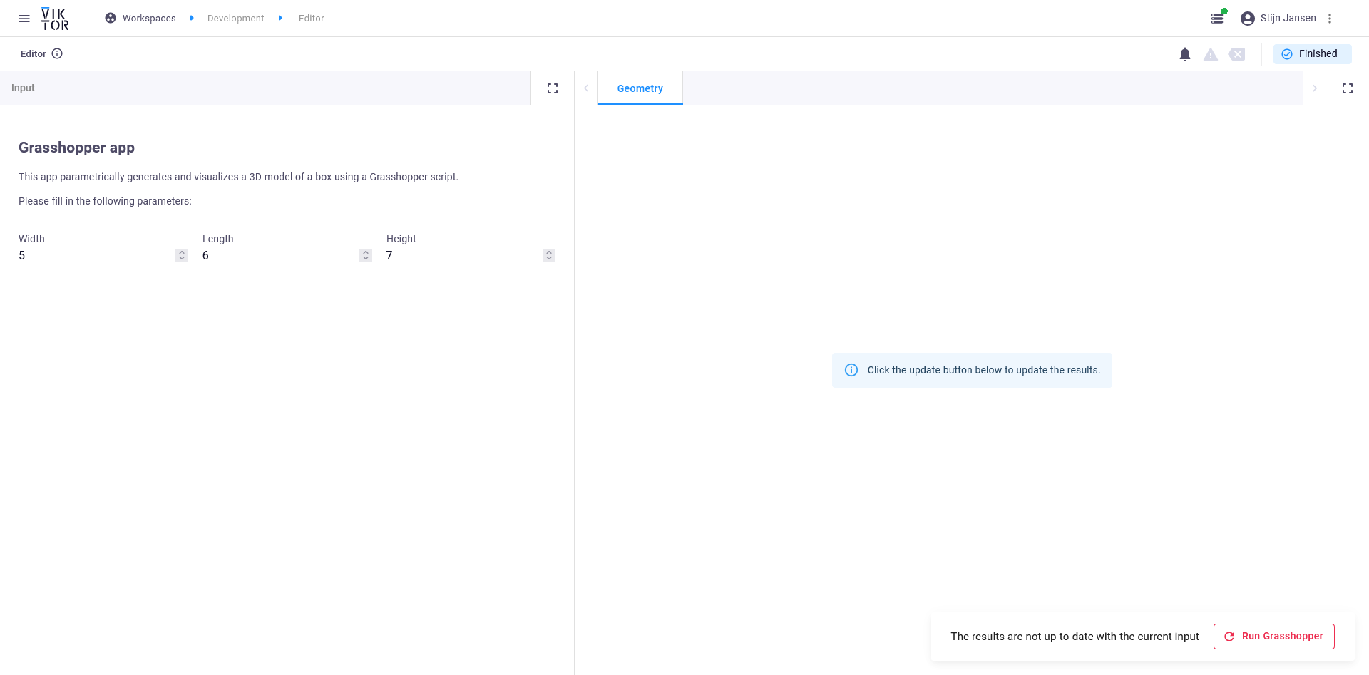

    If you now refresh your app, you should see the following:

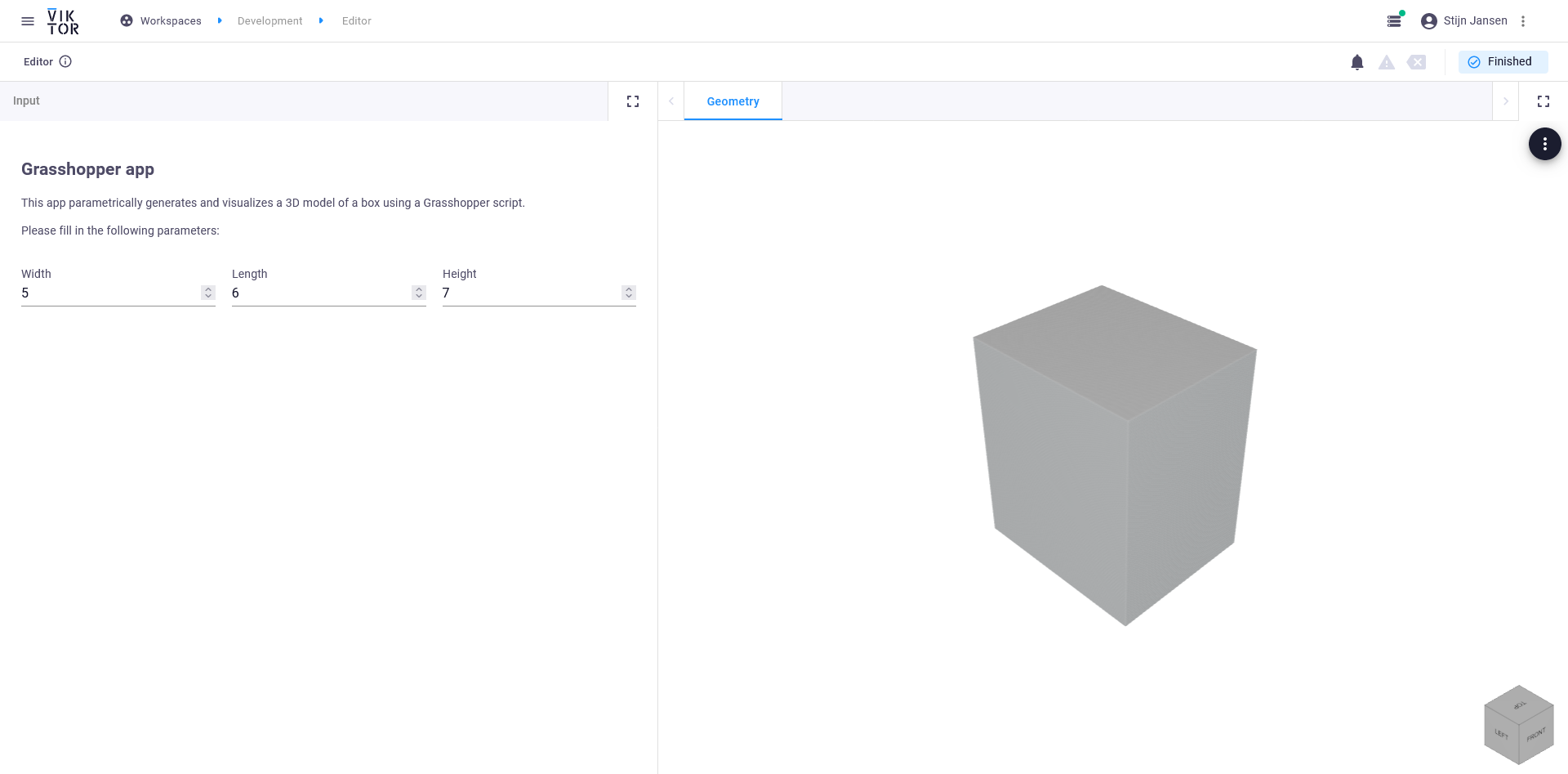

    Now press the Run Grasshopper button (be sure that the worker, Rhino and Grasshopper are running). You should see that Rhino Compute is run by the worker which will result in the following:
    Congratulations, you now have made a VIKTOR app with a Grasshopper model running behind it!

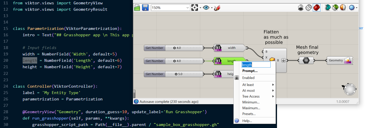

    Extend your Grasshopper model
    As explained in this section, some specific things need to be defined in the Grasshopper model to make the integration work.
    1. Connect your specific input parameters by Hops components. In order to update the parameters via Rhino Compute, create Hops Get Components for the parameters you want to update. As you can see highlighted in the image below, the names need to be exactly the same for the integration to work.
    1. Mesh your final geometry. In order for Rhino Compute to successfully export your geometry you need to mesh it because Rhino Compute can only export a mesh. If you don't, your geometry will not appear in the environment.
    2. Add the Context Bake component. The Grasshopper node Context Bake is needed to bake the model.
    Flatten your inputs
    It is recommended to flatten the inputs in your grasshopper script, especially for simpler/smaller scripts. For larger grasshopper scripts, this may still be true, but it may be more efficient to use the Tree structure as input.
    Want to find out more? Check out the thread on the community.
